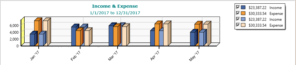

How can I keep this chart from overlapping each other? I have them set on the series to display side by side. See attached.

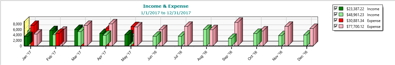

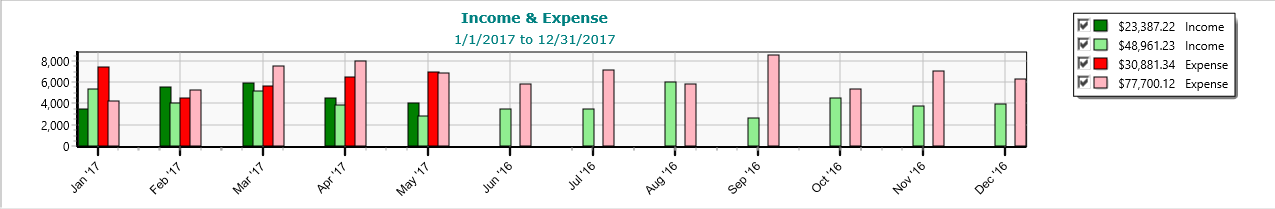

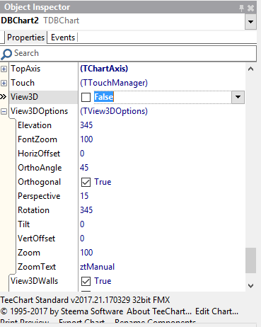

If I set View3d to false, all the bars line up like they are suppose too. Here are 3 images.
1. Chart in 3d
2. Chart without 3d
3. My chart 3d settings
