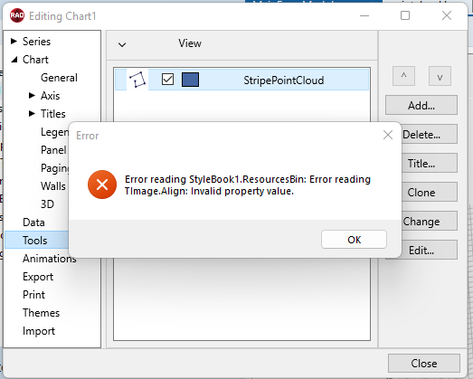

Trying to learn how to some tools on FMX TChart Pro, I am getting this errors.
On the Tee Chart Firemonkey Demo when doing clock on Tools->Gallery I have a error that says "Error reading BaseForm.FormFactor.Devices: Invalid property value.
At design time, If I open the Editor and I do click on tools I get "Error reading StyleBook1. ResorucesBin: Error Reading TImage.Align: Invalid property value"
We are currently using C++ Builder Alexandria 11.0 with TeeChart Pro v2021.33.210915 32bit FMX. but this has been happening for a few releases but never had time to report it.
Any help would be appreciated.

We've been fixing these errors recently.
Please try with the latest version.
