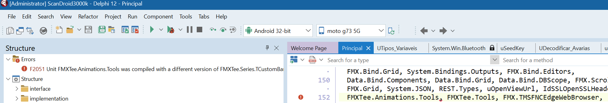

I’m using Delphi 12.3 with TeeChart VCL FMX 2025.44, and when compiling for Android (Application Store) I encounter the fatal error:
F2051 Unit FMXTee.Animations.Tools was compiled with a different version of FMXTee.Series.TCustomBarSeries
This error does not occur when compiling for the Development profile, nor when building the Windows version.
Thank you for your attention, and I look forward to your response.

I've seen there's a problem in TeeRecompile/TeeInstall that makes the backup of the Lite version shipped with the IDE not to be done correctly for android 32 bits.
You should be able to workaround this by moving the library path to the top of the list:

Post by 16498 » Wed Jul 23, 2025 6:11 pm
Hello, the procedure worked for both 32-bit and 64-bit. Thank you very much! — Marcelo
