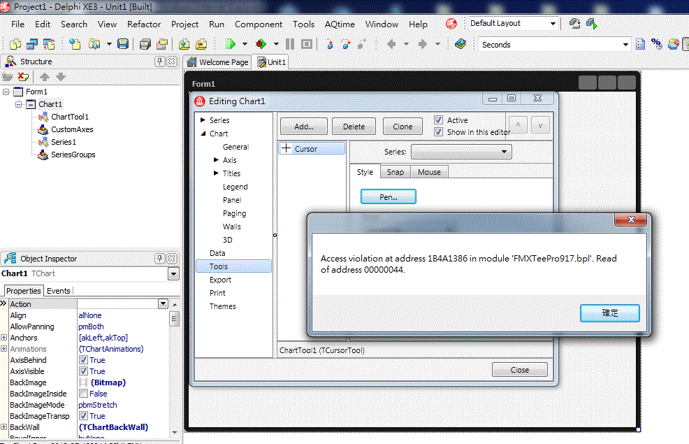

Cursor some Problem
1. can not Set Series
2. can not visible
3. Set Pen Button Access violation

Hi Brian,
You are right. I've reproduced these problems with the TCursorTool in FMX at design time. I've added it to the wish list to be revised for next versions (TV52016367).
