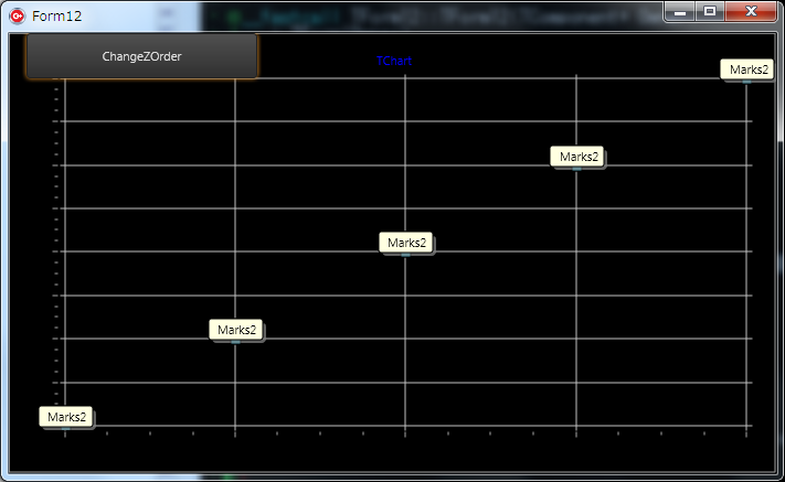

I tried to switch Marks zorder by changing the property of ZOrder of series,
but nothing happened.
Do you have any advice?

	// I tried to bring Series1 to front by changing it's ZOrder,
	//  but the marks of Series1 is still behind Series2
	Series1->ZOrder = 100;

The drawing order is determined by the index of the series in the Chart SeriesList.
As you create the series, Series1 has the index 0 and Series2 has the index 1. So Series2 is drawn after Series1.
You can change this with:
Chart1->SeriesUp(Series2);
SeriesUp and SeriesDown methods are calling ExchangeSeries internally. So another way to do the same in your case:
Chart1->ExchangeSeries(0, 1);
