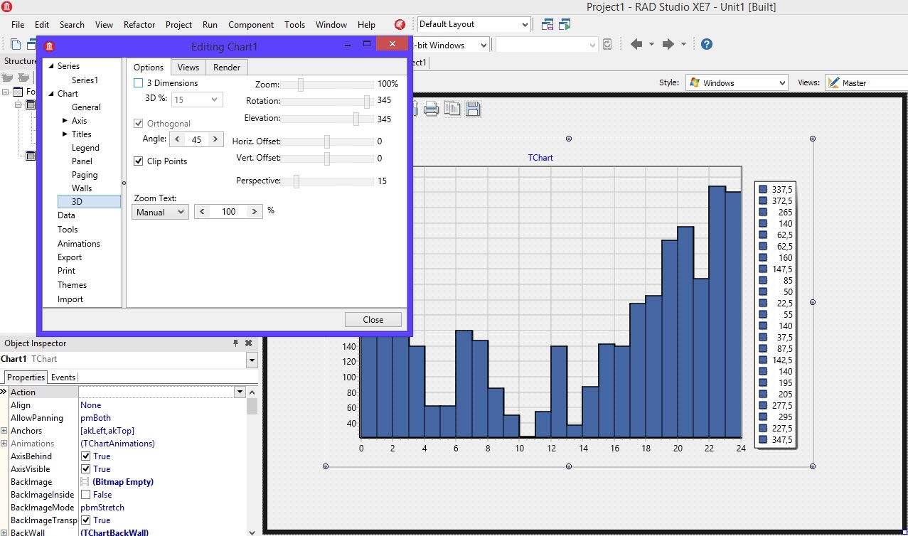

An alternative is add the TAreaSeries in design time in 3D view in Gallery editor and change the 3D view in 3D editor. The image below shows you how:
Hoping it will help.
