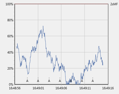

I have a TFastLineSeries that, for every 50th value entered, should display a single character at the bottom of the chart (but above the x-axis). I've got everything working as I intended, except for a small drawing issue. I'm not sure if it is "as designed" or an issue I've overlooked.
The way I've implemented is as follows:
From a timer event I call this:

Screenshot of output:
Please see the small dot right above the 'A'. Why is that there, and what to do to get rid of it? :)

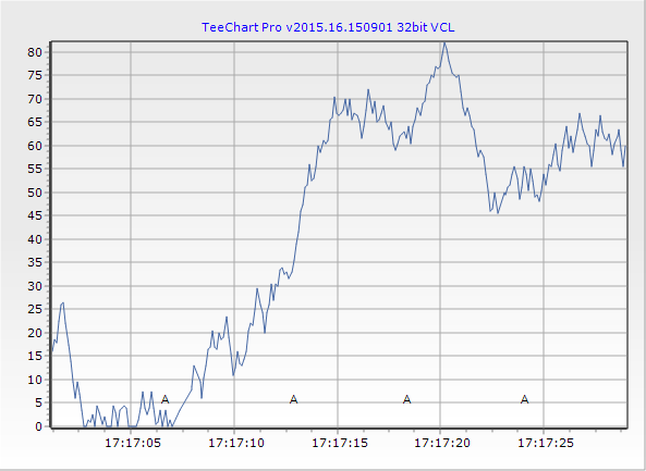

I've added a TChart and a TTimer to a new form and the following code (basically your code plus series and timer initialization):

And this is what I'm getting:
I can't see any dot above the "A"s.
Am I missing any setting? Are you using the latest version available?

I now see it is reproducible in FMX, not in VCL.

I found what happens.
Since you are assigning new Positions to the marks, they are being used. However, the positions (TSeriesMarkPosition) include Width and Height and you aren't initializing them so they are 0.
Then, depending on the framework a rectangle with width=0 and height=0 is drawn (as a dot) or not.
To fix that, you can calculate the Widht and Height:
      APosition.Width:=Chart1.Canvas.TextWidth(Labels[i])+7;
      APosition.Height:=Chart1.Canvas.TextHeight(Labels[i])+5;
Or you can just hide the mark rectangles after creating the series:
Chart1[0].Marks.Transparent:=true;

1. Regarding the drawing issue of the characters (ID Codes): I just did a test where I create a second separate series for the ID Codes. It's a TPointSeries with Style set to "Nothing" to not show the point itself. Now I can add (Assign) a Mark to the point and use the default positioning and thus do not have to implement OnAfterDraw or Series.OnGetMarkText to reposition the Marks when the main graph is scrolling. It seems to work great, so I'll go for this solution.
2. Inconsistent spacing of marks: I agree, the combination of a TTimer and function the Now from the main Thread does not seem to be a good thing in this case. My incoming datastream for the real app (not the demo attached here) does not have a TimeStamp for the incoming datasamples as they are considered live data. Thus I have to use the "Now" function I think, but I'll wrap this part of my app in a separate thread. I would not be surprised if this solves the issue :)
3. Speed: I've done some more testing and on my three available devices it is actually the 10" pad that seems to suffer the most. This device is now running on Android 5.0.1. What I'll do:
