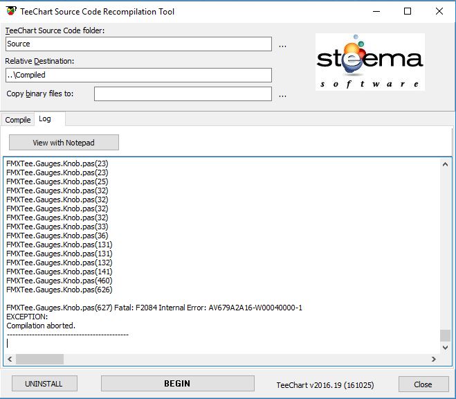

Hi again!
This time I tried to run as administrator the TeeChart Recompilation tool as you proposed.
The error is still visible.
Check the image below.
error
Regarding the source files , we have not modified anyone ad to be sure we run the process in another laptop (second license) and still the same.

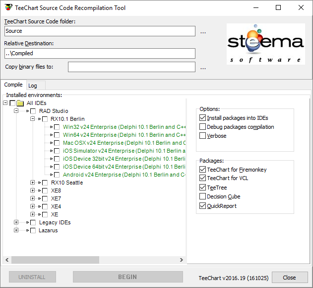

One more thing,
I tried to uninstall TeeChart , install it again (run as admin) and then recompile (as admin).
Behavior was the same. :roll:
Is there any case, any of the options & packages for compilation (in our case I have checked all of them) could create any conflict?
Also, I observed that when tool starts to compile each one of ios/android devices, gui often stucks and window appears like "not responding).
Lets say that for now we can do our job with compilation files for win32/64 , macos and ios simulator: Is there any possibility that this failed compilation has left any unwanted staff ?
BR
Re: error installation Pro VCL FMX
Post by Yeray » Wed Feb 15, 2017 11:54 am
radberlin wrote:Is there any case, any of the options & packages for compilation (in our case I have checked all of them) could create any conflict?
I could reproduce the fatal error you are reporting selecting "Debug packages compilation".
I found another error arises if you select "Decision Cube".
We'll investigate these problems.
