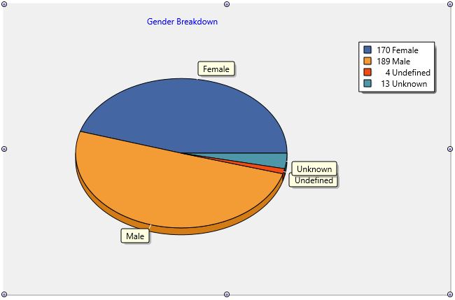

Basically, I have a simple query that returns the following result set that I would like to be able to feed into a pie chart at run-time. Here is what I get when I manually edit the chart in Delphi Berlin 10.2 FMX and attach the query to it:
This is what the end result should look like. This is from design-time editing of the TeeChart.

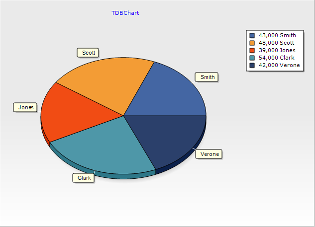

Here a simple test using "TeeChart Pro Database" shipped with the binary installation:
uses Series, DBTables;
var Series1 : TPieSeries;
    Q: TQuery;
  Q:=TQuery.Create(Self);
  Q.DatabaseName:='TeeChart Pro Database';
  Q.SQL.Add('SELECT LASTNAME, SALARY FROM Employee');
  Series1:=DBChart1.AddSeries(TPieSeries.Create(Self)) as TPieSeries;
  Series1.DataSource:=Q;
  Series1.XLabelsSource:='LASTNAME';
  Series1.YValues.ValueSource:='SALARY';
  Q.Active := True;

When I run this, the result set is indeed returned (I've double-checked that). The pie chart looks just fine with this result set when I hook it up to a pie chart in design time. But there's something missing still in run-time.
