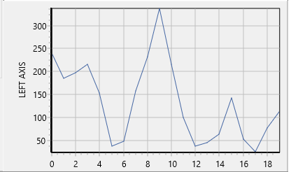

If I use the LeftAxis if then code then I get the following

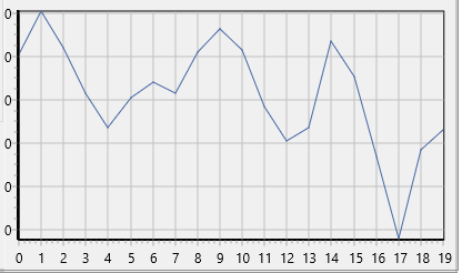

If I use the CustomAxis if then code then I get the following
The only difference in the above is which axes is being used, Left or Custom.
I would expect to get the same result in both cases but I am not and I cannot figure out how to get the custom axis to behave the same as the Left Axis.

Post by Yeray » Mon Nov 27, 2017 9:05 am
Try adding some margins:
  Chart1.MarginLeft:=60;
  Chart1.MarginRight:=20;
  Chart1.MarginBottom:=10;
  Chart1.MarginTop:=10;
  Chart1.MarginUnits:=muPixels;

Thought I had tried the margins. That does solve the problem for the Custom Axes and will work for my case.
However If I use the same code with the Left axis I get the Chart moved over by the margin entered as Expected of a margin.
Therefore if I happen to be mixing axes (Left and Custom) I would need to be aware of this and decide whether or not to add the margin.
I would expect both Custom and Left to work the same.
