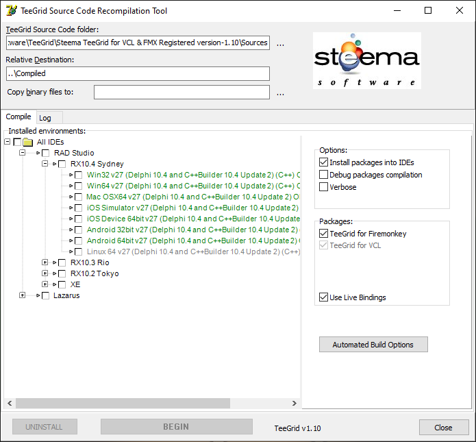

there seems to be a problem,for me at least, latest version , where the teerecompile does not do anything for the Linux compile even though I have that ticked? (I notice the words for linux are greyed out)

I am new user of the latest version Teegrid with source code using Delphi 10.4 Enterprise and FMXLinux but Teerecompile cannot build for Linux due to the option of linux being greyed out.

- Install TeeGrid with sources and run TeeRecompile:
* Note in the image above I compiled TeeGrid for MacOS64. You'd need to do setup a MacOS.

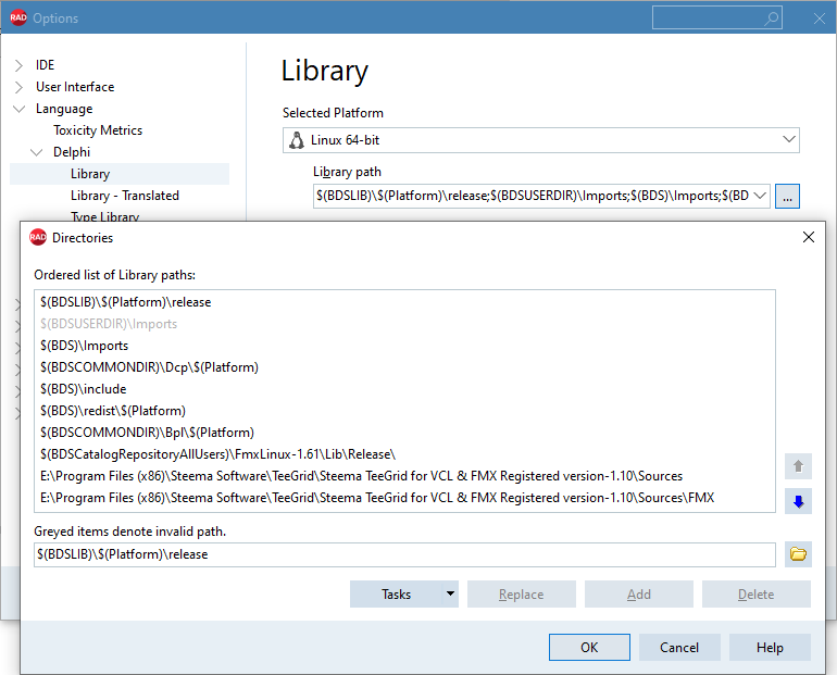

- Add the "Sources" and "Sources\FMX" folders to the "Library path" for "Linux 64-bit" platform:

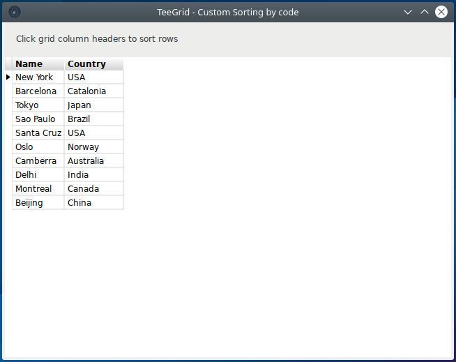

You should now be able to build and run applications in Linux using TeeGrid:

Re: FMX Delphi 10.4 Teerecompile Linux
Post by Yeray » Mon Aug 02, 2021 10:10 am
We've tried to automatize the compilation for linux without success. If we find a way to make it work of course we will enable that.
