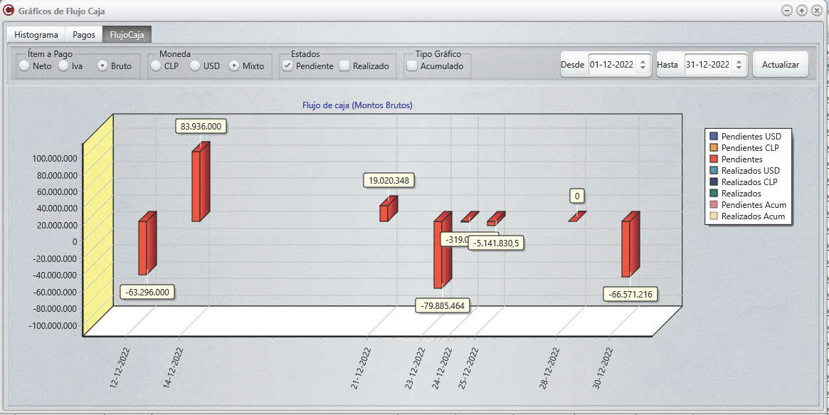

There are six Bar series to show amounts of money on different combinations and two additional Area series to show the balance of the selected Bar. Please see the first 'Bar Series' attached image and keep in mind just one Bar series named 'Pendientes' that is plotted and also just one Area series named 'Pendientes Acum' that is not plotted yet. This first 'Pendientes' series is showing positive and negative amounts of money on their Y-value grouping them by date on X-value. Everything okay until here.

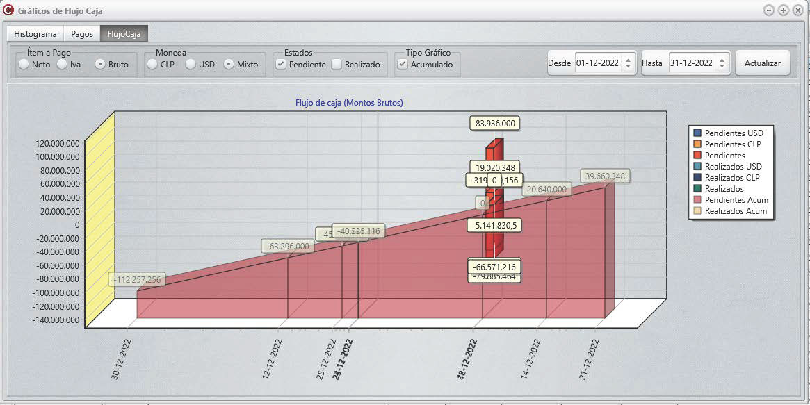

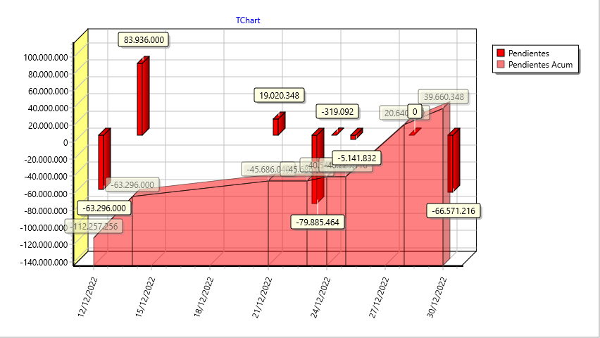

Then I want to show an area chart with the composed balance for each date, with the purpose of to know how the balance is changing through the dates, so I added the other Area 'Pendientes Acum' series, please see the second 'Area Series' attached image, but when I activate their dataset the plotted chart presents two problems that I don't know how to solve:
1. The dates on the X-Value in the horizontal axis are plotted by increasing the money amount instead of increasing the date as in the first Bar series, that is how I need it to have consistency between the two series.
2. It affects the first Bar series modifying their plotting on an unexpected behavior, grouping all bar on a unique point.

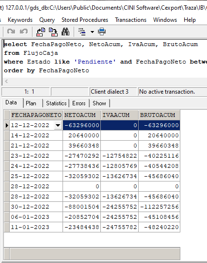

I'm attaching a third image with the dataset values of the Area series where is possible the check that the order is by date and not by ascending amount.

I think the issue could be on how do you calculate the XValues for your "Pendientes Acum" TAreaSeries

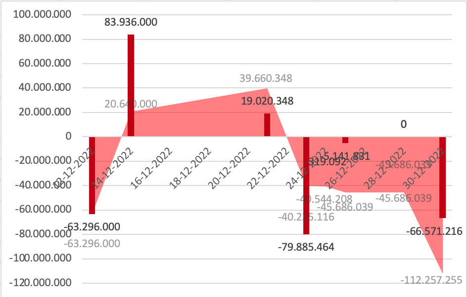

I think you are sorting 'brutoAcum' ascending by it ammount of money, that is exactly my problem because it is not what I expect. What I want is that the Area series with BrutoAcum values be sorted by Date, so it would be plotted consistent with Bar series.
I can see on your simple example chart an Area series with a irregular line at the top instead of a continuos line on my image sent before, but with exactly the same values with the same order from the first to the last one, starting by -112257255 that correspond to the Dec30th 2022, not to the Dec12th 2022 as shows you chart. This specific value must be the last one on the time line.
Moreover, the form of your chart is not the correct one because does not reflex the real accumulated values for this sample dataset. Let me show the expected (correct) chart made with Excel, attached here.
