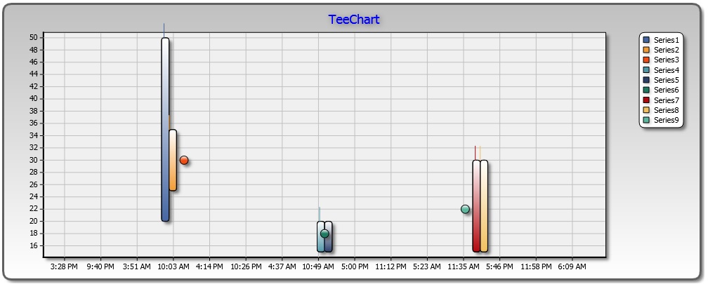

Kindly check the sample code and assist to fix the bar and line position exactly.
For your quick reference we have attached the output chart image.
Thanks!
Re: Generate bar chart based on Min and Max value
Post by Yeray » Wed Apr 13, 2016 2:14 pm
SenSeo wrote: Kindly check the sample code and assist to fix the bar and line position exactly.
I've modified your onDraw function a little bit:

I have also tried with your modified code. But, still the problem remains the same.
Post by Yeray » Mon Apr 18, 2016 8:58 am
This is what I'm getting:
with this code:

As per your attached image, bar and point is not plotted to correct position even I have used the same x-axis value for both.
Post by Yeray » Thu Apr 21, 2016 8:06 am
I thought we were talking about drawing lines on top of the bars. But I understand we are now talking about the pointers of the line series.
I'm afraid this isn't possible at the moment. The problem is we are using many Bar series to workaround the origin limitation but this makes the chart to think there are many bar series being drawn at each value, and it's leaving space for all them; but the points from the Line series (why don't you use a PointXY series?) are always drawn at the center of the values, giving this effect.
But I've been working with it to try to give you some alternative. And I think the best would be to improve the Bar series to accept an array as "origin", so you can use only two Bar series and a PointXY series instead of repeating all them.
With this modification, if I do this, without the for loop:
    var myFormat = new Tee.Format(Chart1);
    var series, series1, series2, today = new Date().getTime();
    var values = [50, 20, 30];
    var minValues = [20, 15, 15];
    var values1 = [35, 15, 30];
    var minValues1 = [25, 20, 15];
    var avg = [30, 18, 22];
    var msecsInADay = 86400000;
        series = Chart1.addSeries(new Tee.Bar(Chart1));
        series.data.values = values;
        series.data.x = [];
        series.data.x = [new Date(today + msecsInADay), new Date(today + 2 * msecsInADay), new Date(today + 3 * msecsInADay)];
        series.marks.visible = false;
        series.useOrigin = true;
        series.origin = minValues; //teechart.js modified to accept an array here
        series.barSize = 8;
        series1 = Chart1.addSeries(new Tee.Bar(Chart1));
        series1.data.values = values1;
        series1.data.x = [];
        series1.data.x = [new Date(today + msecsInADay), new Date(today + 2 * msecsInADay), new Date(today + 3 * msecsInADay)];
        series1.marks.visible = false;
        series1.useOrigin = true;
        series1.origin = minValues1; //teechart.js modified to accept an array here
        series1.barSize = 8;
        series2 = Chart1.addSeries(new Tee.PointXY(Chart1));
        series2.data.values = avg;
        series2.data.x = [];
        series2.data.x = [new Date(today + msecsInADay), new Date(today + 2 * msecsInADay), new Date(today + 3 * msecsInADay)];
        series2.format.stroke.size = 10;
        series2.pointer.visible = true;
        series2.pointer.style = "ellipse";
I've added it to the public tracker and closed the ticket:
http://bugs.teechart.net/show_bug.cgi?id=1517
So the next maintenance release will include this change.
