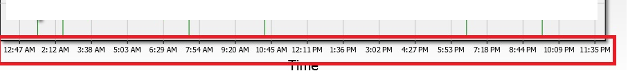

Hello Team,
We are generating the chart for Bar/Line/PointXY. We are using the date-time/date format for the X-Axis. The problem is, we are unable to customize the X-Axis date/date-time format. Below is my code,
Chart1.axes.bottom.setMinMax(new Date(2000, 1, 1, 0, 0, 0).getTime(), new Date(2000, 1, 2, 0, 0, 0).getTime());
Chart1.axes.bottom.labels.dateFormat = "shortTime";
Can you please assist to customize the X-Axis values for the Date/Date-Time format?
We have attached the images for your reference.

According to dateFormat.masks in date.format.js, "shortTime" means "h:MM TT" so your image looks correct, isn't it? What result would you expect?
Or maybe you are getting another result and the image shows the result expected. In that case, could you please post the wrong result you are getting?

Yes. Date time format is displaying as expected. The problem is, I would like to set the increment option to the bottom axes(X-Axis). I have attached the expected output as image here for your reference.
If the bottom axes is an integer, we could able to set the increment option. But, for the date time format, unable to set the increment.
Note : Actually, I need to show only 12:00 AM, 6:00 AM, 12:00 PM, 6:00 PM etc., instead of showing the complete 12 hour format.
