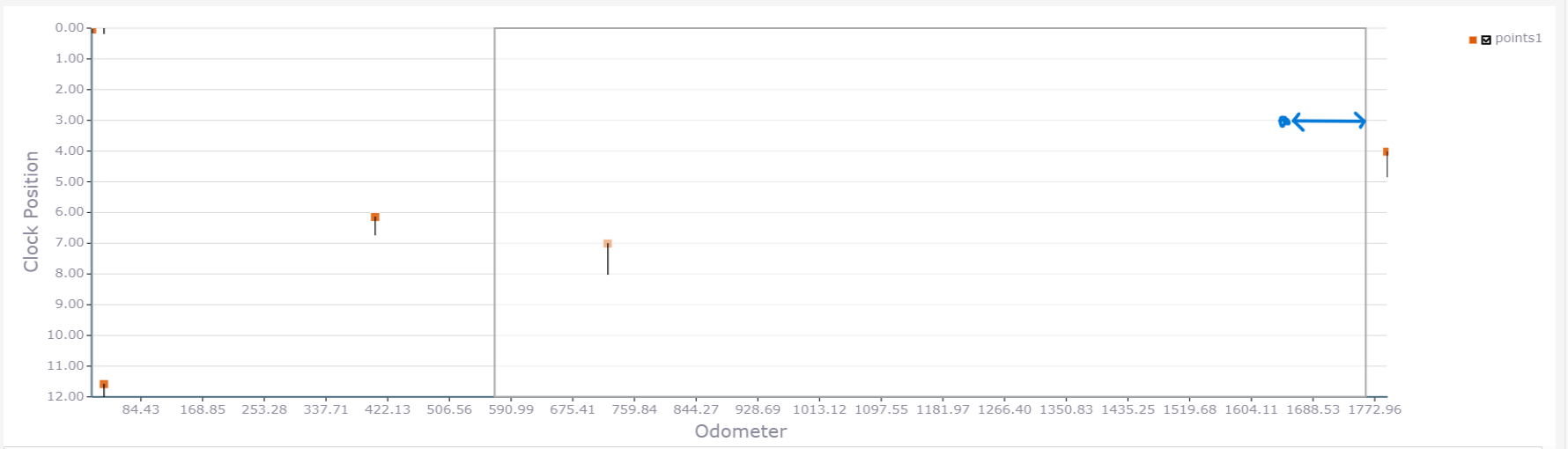

I have a chart being in rendered into the following canvas.
<tally-chart>
	<canvas id="canvas1" height="500" style="border: 0px solid #808080;" oncl />
</tally-chart>
I am trying to get my chart to extended to the end of my window without hard coding in a width.
I currently have width set to 100% as follows.
tally-chart {
    display: flex;
    width: 100%;
    padding: 0;
    border: none;
    margin: 0;
    height: 500px
tally-chart > canvas {
    display: flex;
    width: inherit;
    height: inherit

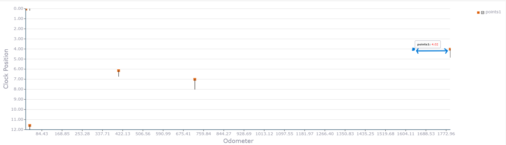

An issue I am having though is the further I move my mouse cursor to the right, the more the chart thinks it is offset. I believe what is happening is the chart image is rendering into the canvas, and then the canvas is stretching to fill the screen. As a result it looks the chart doesn't recognize the correct location of the cursor. Is there a work around for this?
Screenshot (4).png (48.38 KiB) Viewed 35738 times
Screenshot (2).png (46.66 KiB) Viewed 35738 times
