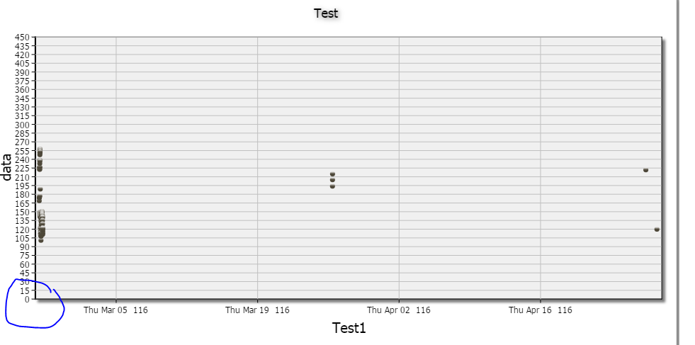

I created a sample program with test data. If you run this program, you can see the chart as attached image here. Here the problem is that x-axis start date is 26/2/2016, so the x-axis label value should start with this date from 0th grid but started from 1st grid of graph.

Re: Custom label with multiple series - Urgent
Post by Yeray » Wed May 18, 2016 11:01 am
First of all a couple of notes:
- The bottom axis labels dateFormat you are setting isn't working fine because you haven't included the date.format.js.
- The UTC dates you are creating have an incorrect year. That's why you get that "116". Change all the getYear() calls in your code for getUTCFullYear() to fix it.
- I see you are using labels.angle to rotate the bottom axis labels without effect; try with labels.rotation.
Regarding the issue with the first label at the left part of the bottom axis, try setting roundFirst to false:
Chart1.axes.bottom.labels.roundFirst = false;

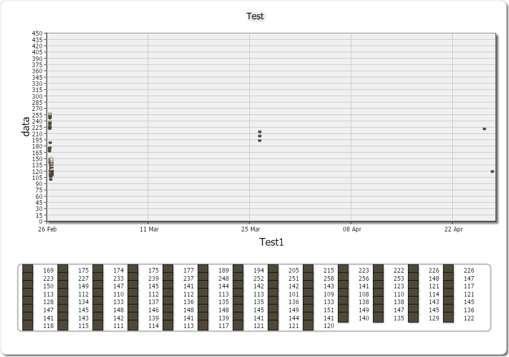

Thanks for your reply.I done the modification as per your instruction and attached the code below. I am still facing the first label at the left part of the bottom axis, label is not displayed at the first position of the grid. Am I missing something in the code below?
Post by Yeray » Thu May 19, 2016 1:38 pm
I've only changed the includes to be sure we are using exactly the same version:
    <!--[if lt IE 9]>
    <script src="http://www.steema.com/files/public/teechart/html5/latest/src/excanvas/excanvas_text.js"></script>
    <script src="http://www.steema.com/files/public/teechart/html5/latest/src/excanvas/canvas.text.js"></script>
    <![endif]-->
    <script src="http://www.steema.com/files/public/teechart/html5/latest/src/teechart.js" type="text/javascript"></script>
    <script src="http://www.steema.com/files/public/teechart/html5/latest/src/date.format.js" type="text/javascript"></script>
And I got a correct result in Chrome:
