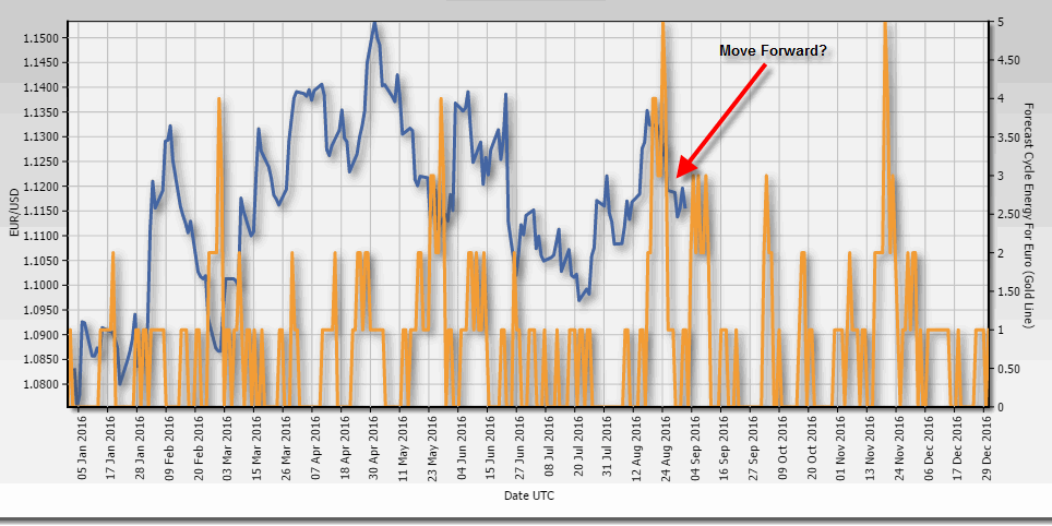

Without recoding my javascript too much -
Is there an easy way to move one series in front of another as it's being blocked.
I know I can recode and the series in a different order but I do a lot of index based updates and such and would rather not have to change that.
is there a Z-Order property or MoveSeriesUp or something like that?
Thanks so much,
Joseph
Need to move blue line forward.

The series are in an array you can swap elements from as with any array. Ie:
            var tmp = Chart1.series.items[0];
            Chart1.series.items[0] = Chart1.series.items[1];
            Chart1.series.items[1] = tmp;
If you want to do it with a function:
        Array.prototype.swap = function(a, b) {
            var temp = this[a];
            this[a] = this[b];
            this[b] = temp;
And then:
            Chart1.series.items.swap(0,1);

Hi Yeray --
I think this is the same as just adding the series to the chart in a different order.
All my code that is array based will still have to be modified.
I was hoping for an answer that wouldn't require change all my array based index code.
Such as Series1.ZOrder = 0 or something like that.
I do appreciate your help however.
I'll just rewrite my code it's not a huuuuge deal. :)
Thanks again.
