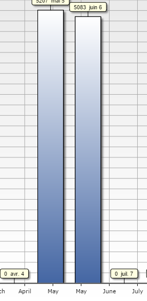

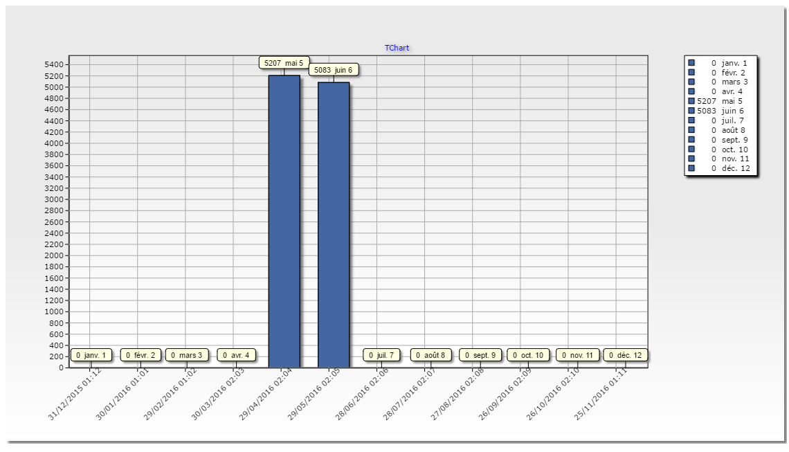

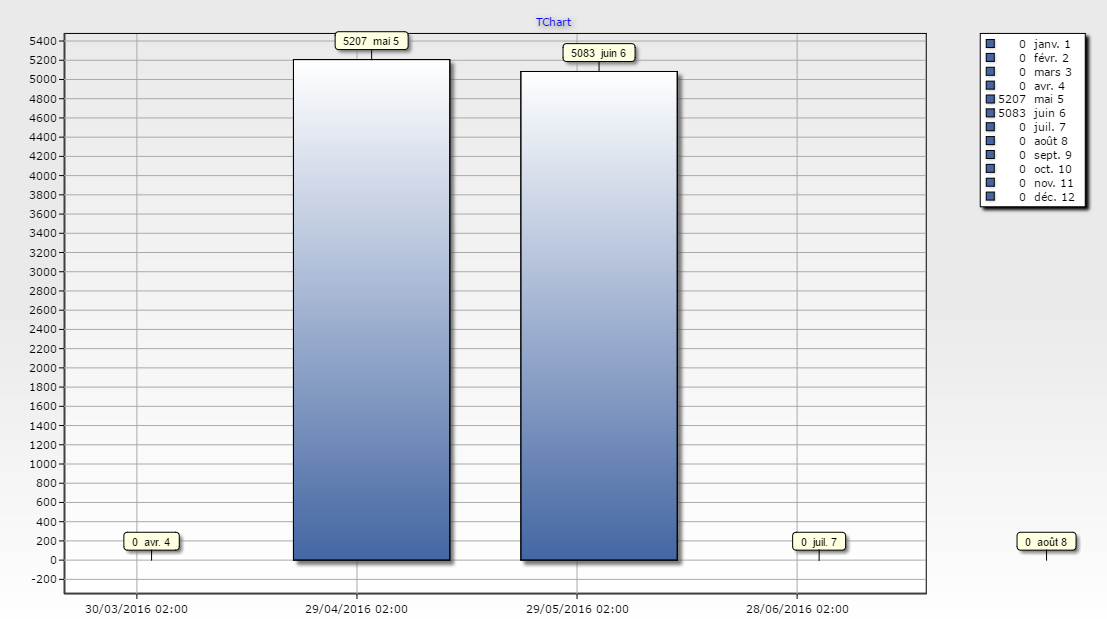

I have problem with graphic with increment month, the date for each bar is not correct.
The increment seems fixed of 30 days.
If I chose automatic increment, it doesn't work anymore.
ProjectAxisIncrementMonth.zip
(5.38 KiB) Downloaded 1779 times
Re: Problem using increment Month
Post by Yeray » Mon May 08, 2017 9:53 am
The VCL project you've attached gives me a slightly different Javascript output for me:
TestOneMonthIncrement.zip
(1.35 KiB) Downloaded 1860 times
So I assume you modified it to get that result.
Post by Yeray » Tue May 09, 2017 8:22 am
You could reset the x values and the increment as follows:
  for (var i=0; i<Series1.data.x.length; i++) {
      Series1.data.x[i] = i;
  Chart1.axes.bottom.increment=1;
