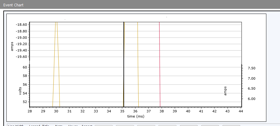

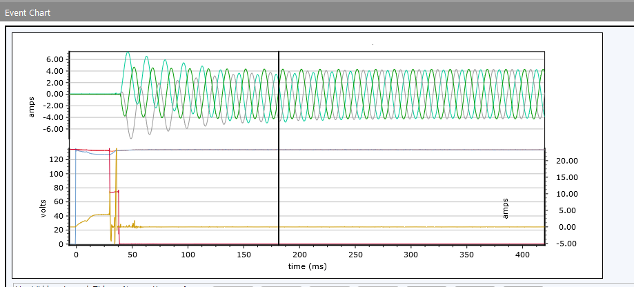

TeeChart(tm) for JavaScript(tm) version V1.4. I am facing issue with zoom and scroll after adding a custom Y -axis. In all I have 2 axes on left side one axis at the bottom and one on the right.
// Axis positions as % percent:
axisLeft1.start = 0; axisLeft1.end = 45; // custom axis
axisLeft.start = 50; axisLeft.end = 100;
axisRight.start = 50; axisRight.end = 100;
On zoom (horizontal and vertical enabled) and scroll (up and down) the series are not bound to their respective axis and the lines cross over (chart attached).
Also, when the chart first renders the title text for the custom axis does not show up until there is an activity (mouse click etc.) by the user.
I also had a question regarding cursor tool. Can I add two cursor tools on a chart that act independently? Currently, when I add two cursor tools the onChange event for one results in changing the position of the other cursor tool and they are always superimposed. I want each of the cursor tool respond to its own change event.
Any help /suggestions in form of sample code snippets would he appreciated.
View when zoomed in. The series at the bottom takes the entire chart space
Charts default view
