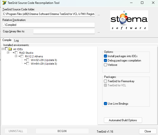

I just ran the recompile tool with the attached settings. What do I do now?
recompile tool.png (38.28 KiB) Viewed 13026 times

Hmmm.... I see a "VCLTee.Editor.Painter.GDIPlus" .pas and .dfm in the sources VCL folder for my 1.17 installation and the demo runs correctly "demos\VirtualData\Array\TeeGrid_Array_Data.dproj". I do have the source pathed though. I'll check with a clean installation.
I confirm that the compiled unit is not present in Compiled\Delphi29.win32\Lib
If you add a search path in the project directly to the sources\vcl folder, does the project compile/run ok?

..I've checked. VCLTee.Editor.Painter.GDIPlus is missing from the VCLTeeGrid.dpk file.
We'll add the entry for the next release (being prepared now). As an interim you can manually add it as a last line to that file before running TeeRecompile.
eg.
  VCLTee.Editor.Grid.Ticker in '..\VCL\VCLTee.Editor.Grid.Ticker.pas' {GridTickerEditor},
  VCLTee.Editor.Painter.GDIPlus in '..\VCL\VCLTee.Editor.Painter.GDIPlus.pas' {GDIPlusEditor};  <--- new line
end.
Thank you for the bug report.
