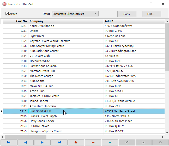

What version are you using? Here, using v1.03 I see the last row and the horizontal scroll bar without problems. Ie, running the example from "demos\VCL\Database\ClientDataSet":

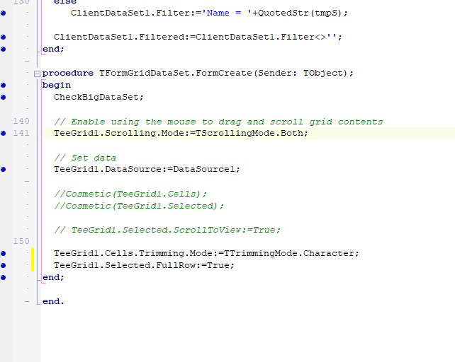

Here it is how it works for me:
Note I've added a line of code at the end of the FormCreate in that example to select the FullRow:
  TeeGrid1.Selected.FullRow:=True;

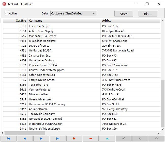

HarryKalma wrote:Yes. VCL demo work fine. Only - I use FMX.
I'm trying to reproduce the problem of the horizontal scroll bar in FMX with the example at "demos\FireMonkey\Database\DataSet" without success. It seems to work fine for me here:
