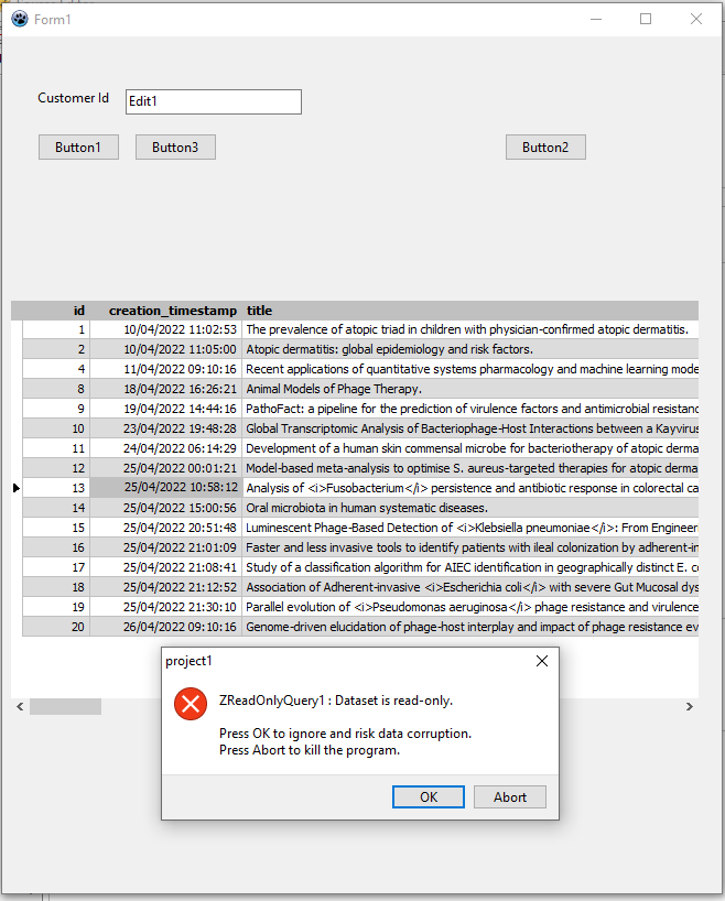

I have a gird with ReadOnly set to true. While I tried to copy data from one of the cells I accidently pressed ctrl+v (paste) and got the following error:
"Dataset is read-only"
That should never happen, if the grid is in ReadOnly mode it should block any attempts to change the content from user interactions.
Configurations : Window 10, Lazarus 2.0.10

I've tried with the example here and got a 'EDatabaseError' exception with the message:
Dbf1 : Operation not allowed, dataset "Dbf1" is not in an edit or insert state.
Not exactly the same error you reported, but enough to add it to bugzilla (#2524).
