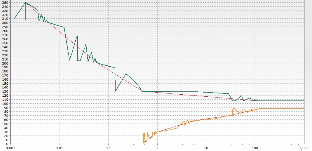

I'm playing with the VCL 2010 demo and I've found a weird behaviour of the Smooth function. It works properly if I define all series and smooth functions (related to those series) using the "Edit chart" option. But if I define series and functions at my source code (exactly the same series and properties as I did before), the smooth functions are not smooth at all. They follow the reference series, but have big deviations (see the attached file, please).
Is this fixed at the release version?, because we were planning to upgrade to use it.

I can see that having some points very near in XValue (in comparison with the other points proximity) the smoothed seems to give an strange behaviour.
Delphi example:
uses Series, TeeSpline;
var Series1, Series2: TLineSeries;
    TeeFunction1: TSmoothingFunction;
  Chart1.View3D:=false;
  Series1:=Chart1.AddSeries(TLineSeries.Create(self)) as TLineSeries;
  Series1.AddXY(0,100);
  Series1.AddXY(100,130);
  Series1.AddXY(100.25,105);
  Series1.AddXY(200,155);
  Series2:=Chart1.AddSeries(TLineSeries.Create(self)) as TLineSeries;
  TeeFunction1:= TSmoothingFunction.Create(self);
  Series2.SetFunction(TeeFunction1);
  Series2.DataSource:=Series1;
I've added it to the defect list to be revised in future releases (TV52014879).
