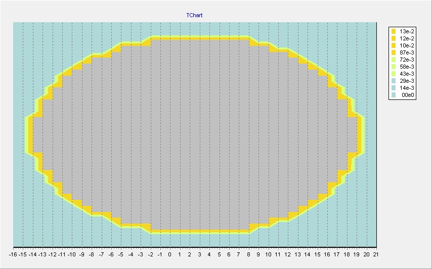

toxi
Posts: 4
Joined: Mon Jun 15, 2009 12:00 am
Re: TIsoSurfaceSeries and XZ plot
Post by toxi » Sun Feb 27, 2011 7:42 pm
There was a mistake on the screenshot from your previuos post: the central area of figure must not be grey colored. Maybe it is a bug with a Palette using. I found what the subfunction CalcFirstLevel of method TIsoSurfaceSeries.DrawCell(x, z: Integer) returns the wrong result - second level in palette. I changed the CalcFistLevel how it looks below. You can see the result on screenshot. It seems that the Controurseries and IsoSurfaceSeries fill correctly.

Filled ContourSeries
