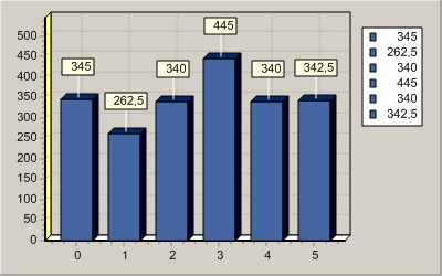

I haven't tried it with WebBroker, but creating a simple chart with GDIPlus and exporting it to jpg/png seems to work fine for me here.
uses Chart, TeeGDIPlus, Series, TeeJPEG, TeePNG;
var mynewchart: TChart;
    gdiCanvas: tTeeGDIPlus;
  mynewchart:=TChart.Create(nil);
  mynewchart.Parent:=Self;
  gdiCanvas := tTeeGDIPlus.create(nil);
  gdiCanvas.TeePanel:=mynewchart;
  gdiCanvas.Active:=true;
  mynewchart.AddSeries(TBarSeries).FillSampleValues;
  TeeSaveToJPEG(mynewchart, 'C:\tmp\mynewchart.jpg', mynewchart.Width, mynewchart.Height);
  TeeSaveToPNG(mynewchart, 'C:\tmp\mynewchart.png');
