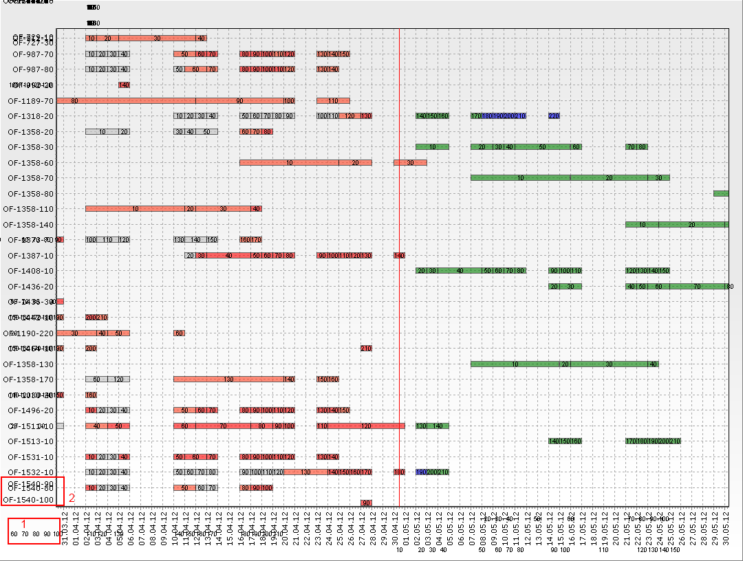

I have a TChart on which I build several TGanttSeries and one TLineSeries at run time.
Each TGanttSerie represent a step in a production process, each "line" represent one process. So each bars use its step number as a mark and I use LeftAxis.Items to display the correct labels.
For <Each Item on the lowest series> do
          Chart_VisuOperation.LeftAxis.Items.Add(groupIndex, groupName);
          Chart_VisuOperation.LeftAxis.Items.Automatic := False;
Also, I have inverted my left axis as I need the line to be displayed in chronological creation order.
As we can have a lot of those lines I want to limit the simultaneous displayed results to 30. Also, as the data can span quite a long period, I limit the bottom axis to up to 60 days.
If there is less than 30 lines or 60 days, I don't put a limit on the axis.
I use two TChartScrollBar to manage the scrolling.
On to the problems :
1) When the marks are out of the main drawing zone but still in the component drawing space, the marks are displayed through the axis labels (this one is annoying but not a major problem)
2) When I scroll the lines vertically, the labels tends to stick on screen and overlap each other. This one is quite problematic as it's quickly impossible to read anything.
Bath are displayed in red box on the attached picture.
Screenshot of the problems
apperçu planif.gif (61.64 KiB) Viewed 5277 times

Re: TChart : Axis Items overlaping
Post by Yeray » Wed May 02, 2012 9:05 am
Hi Nicolas,
It sounds similar to this.
Here you have the same workaround the customer proposed, translated to delphi:
procedure TForm1.CalcLabels;
var LabelIndex: Integer;
  with Chart1.Axes.Left do
  for LabelIndex:=0 to Items.Count-1 do
    if (Items.Item[LabelIndex].Value > Maximum) or (Items.Item[LabelIndex].Value < Minimum) then
      Items.Item[LabelIndex].LabelPos:=-10;
You could call this CalcLabels method at the scroll/zoom/unzoom events
Post by Nicolas Pierre » Wed May 02, 2012 9:47 am
Thanks a lot it works quite well when put in the "OnBeforeDrawAxes" event, even if it slow a bit then movement of the chart.
Well, now if you could help me with the marks, I would be completely happy.
Post by Yeray » Wed May 02, 2012 11:11 am
Hi Nicolas,
Sorry, I forgot it.
Try with:
Chart_VisuOperation.Series[0].Marks.Clip:=true;
