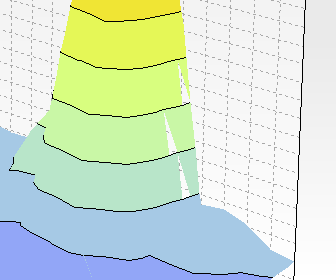

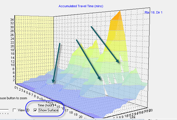

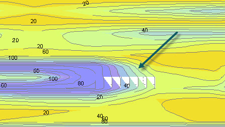

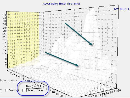

Does anybody know the setting to resolve these incorrectly filled surfaces on a contour and IsoSurface series?
21-Apr-12 10-58-30 AM.jpg (97.51 KiB) Viewed 14681 times
21-Apr-12 10-58-58 AM.jpg (86.06 KiB) Viewed 14683 times
21-Apr-12 11-05-49 AM.jpg (59.06 KiB) Viewed 14689 times
This seemed to have occurred since upgrading to TeeChart Pro 2012.05.120327, but i cannot seem to resolve.
The holes are not in my data. There must be some setting but I cannot find it.

Post by Yeray » Mon Apr 23, 2012 11:01 am
This seems to be the same discussed here.
I'm afraid [TV52012990] hasn't been fixed yet.

It would be helpful if we could identify what maintenance release broke this. You said:
Track1 wrote:This seemed to have occurred since upgrading to TeeChart Pro 2012.05.120327, but i cannot seem to resolve.
In the threads mentioned above, the problem seems to be reproducible since TeeChart v8. But I see you had TeeChart v7, v8 and v2010 before the actual. So, could you please tell us what was the latest exact maintenance release it seemed to work fine for you?

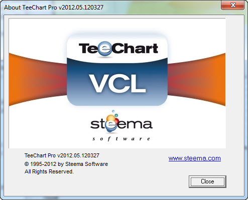

Post by Track1 » Wed Apr 25, 2012 11:40 am
Thanks Yeeray
I'm not absolutely positive that it broke from a maintenance release. I had seen this before but not for some time, so I thought a setting I had chosen must have resolved it. I may be wrong on that point though
However, before this version I can advise that I was definitely running TeeChart Pro 8.06.60902
On the computer with the issues, I am now definitely running
25-Apr-12 9-36-20 PM.jpg (46.86 KiB) Viewed 14590 times

Post by Yeray » Wed Apr 25, 2012 12:21 pm
Revising the threads where this was discussed, I see a customer who found it solved with an installer we made for him.
Could you please tell us what IDE are you using so we can try the same?
It would also be helpful if you could send us a simple example project we can run as-is to reproduce the problem here so we can check it here too.

Post by Yeray » Thu Apr 26, 2012 8:52 am
Hi Trevor,
I'm afraid the same build that solved the problem for that customer, doesn't seem to solve the problem in your example.
The TSurfaceSeries seems to be drawn without this problem, but the TContourSeries.
var tmp: TChartSeries;
  tmp:=MyContourSeries;
  ChangeSeriesType(tmp, TSurfaceSeries);
We're still investigating this and we'll be back to you as soon as we get some conclusion.

Post by Yeray » Wed May 02, 2012 10:57 am
Hi Trevor,
Excuse us for the delayed reply here.
I found the v2011.03 seems to work fine for me here with your application. Could you please give it a try?

Post by Yeray » Thu May 03, 2012 9:02 am
Hi Trevor,
The changes introduced that broke this for your dataset were applied to fix a similar problem with another particular dataset. Reverting the changes would fix the problem in your case but make it reappear some other customer(s). I thought the best solution is to study this particular case and try to find a fix for it. That's why I suggested you an old maintenance release in the meanwhile.
Since you are a source code customer, you could also try to copy the v2011.03 TeeSurfa.pas file in the v2012.05 sources, backing up & overwriting the v2012.05 TeeSurfa.pas and try to recompile the v2012.05 sources. This works for me in D7 but I haven't tried it for XE/XE2.

Hello Yeeray

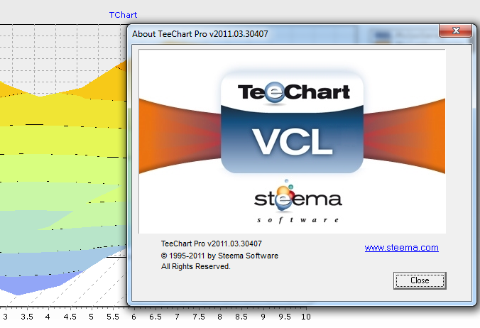

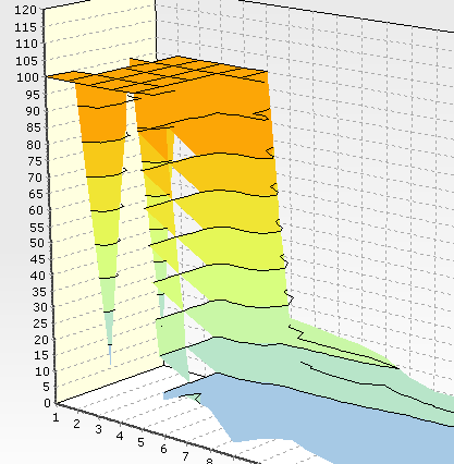

I downloaded and installed 2011.03 Delphi6 (binary installer version)
Unfortunately, the problem was not resolved with that version.
06-May-12 6-34-29 AM.png (8.06 KiB) Viewed 14461 times
06-May-12 6-54-26 AM.png (19.42 KiB) Viewed 14461 times
I could never get the 2012 source code installer to work, see: http://www.teechart.net/support/viewtop ... =3&t=13167, so I only had the 2012 binary installer working.
I downloaded and installed the source code version for 2011.03, and the result was exactly the same as above
How can I provide further assistance to Steema to resolve?
