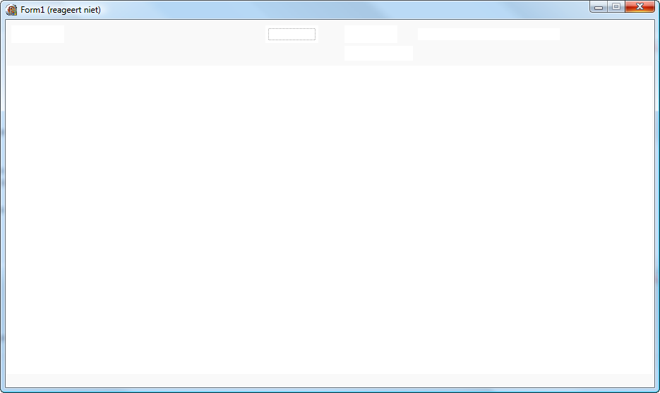

I can compile the test application without problems, but it won't run on my machine. See the attachment.
The application fine on some other computers.
Bert

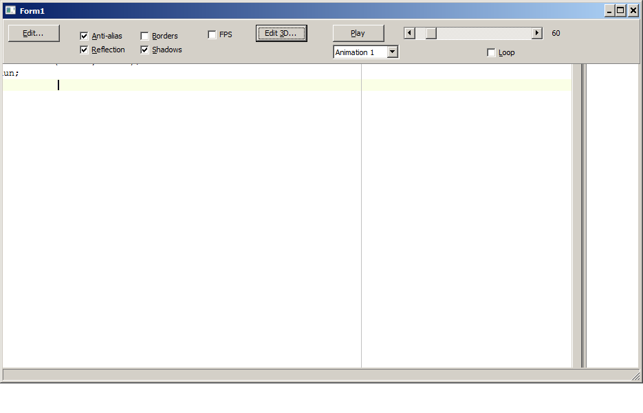

Hi both!
I can compile the app without problems, but when running I'm getting the Overflow exception.
I tried in a second computer with same results.
With a 3rd machine I got something similar to Bert, the frame of the app but nothing showing inside.
If you need my compiled exe to analyze what can be wrong, just ask...

I'm not able to reproduce the error, but I see a similar (but not exactly equal) blank window when executing the project in a Win7 64bit machine and RAD XE2. Here it is what I see: And if I click on the "Edit 3D..." button, then everything looks correct.
Could you please give it a try?

I have already posted my screen shot where I don't see the 'Edit 3D...' button.
Today I ran the application on another computer and noticed that it is using all CPU power of one core. That is also happening on my main development machine.
Can you create a test application with a lot of logging (using OuputDebugString for example)?

We've ran the PieDemo example in several machines and found it seems to behave differently in them, apparently doing the same.
- In some of them, we get this. In this case, if we move the focus to another application (before clicking the "Edit 3D..." button), then we get a completely unresponsive application, like here.
- In others, we get a StackOverflow if the mouse is over the chart when the form is trying to be shown. If the mouse is far from it, nothing is show (no form, no error) but we see the application executing in the Task Manager, and ending the execution without any intervention.
We are still investigating this.
