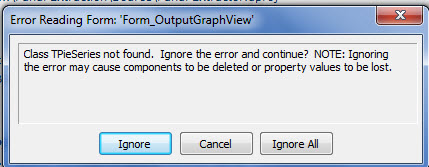

Hello I have an interesting problem. I had some troubles adding The Steema compoonent to Delphi - but it seems to be working now - except when I open an existing project.
I get the error "Class TPieSeries not found." This is interesting because if I open a new project - add a Tchart - then add a TPieSeries - then it will compile - both the new project - and the existing one. This will work until I close Delphi and open it again. At that point the issue reappears.
Any thoughts as to what might be causing this?

Post by Yeray » Mon Jul 30, 2012 3:01 pm
Hi Bradley,
Give it a try to the workaround suggested here:
http://www.teechart.net/support/viewtop ... und#p52884
