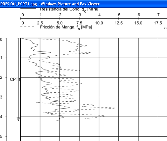

Hello all,
Can anyone please inform me if it is possible to have a plot like the one in the picture? Basically I do not know if I can create that "double" X axis :)
Thank you all for your time.
Re: Help needed for a new plot
Post by Narcís » Fri Oct 19, 2012 7:52 am
Hi johnnix,
I'd first try assigning series horizontal axis to both standard horizontal axes: bottom and top. Then I'd position the bottom axis on top of the chart and adapt the margins as needed. For more information on how to do that please read tutorial 4. Tutorials are available at TeeChart's program group.

Hello Narcis,
Thank you very much for your prompt reply. I have the source version installed and do not have the samples, is it possible for you to upload some sample on how to create the double X axis?
