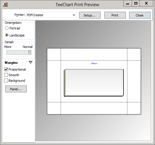

Can't reproduce this with TeeChart v2014.10 in Delphi 2010. I've created a new project, dropped a TChart, a TButton and a TChartPreviewer component to the form. Note by default the TChartPreviewer is called ChartPreviewer1 so my code looks like this:
  ChartPreviewer1.Chart:=Chart1;
  ChartPreviewer1.Execute;
And when I execute it, I see the chart in the preview as expected:
Andreas iCD wrote:Even if I try the following, I get the same result:
TeePreview(Self,Chart1);
In the simple example above, I add a second TButton, TeePrevi unit to the uses clause and then I can call the code you mention. And I get the same correct result mentioned above.
