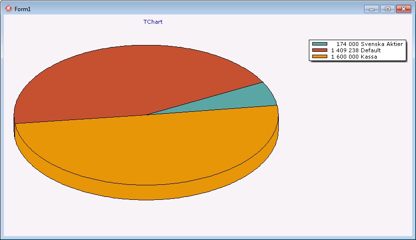

Everything is ok:
All is fine...
Pie ok.jpg (53.78 KiB) Viewed 5227 times

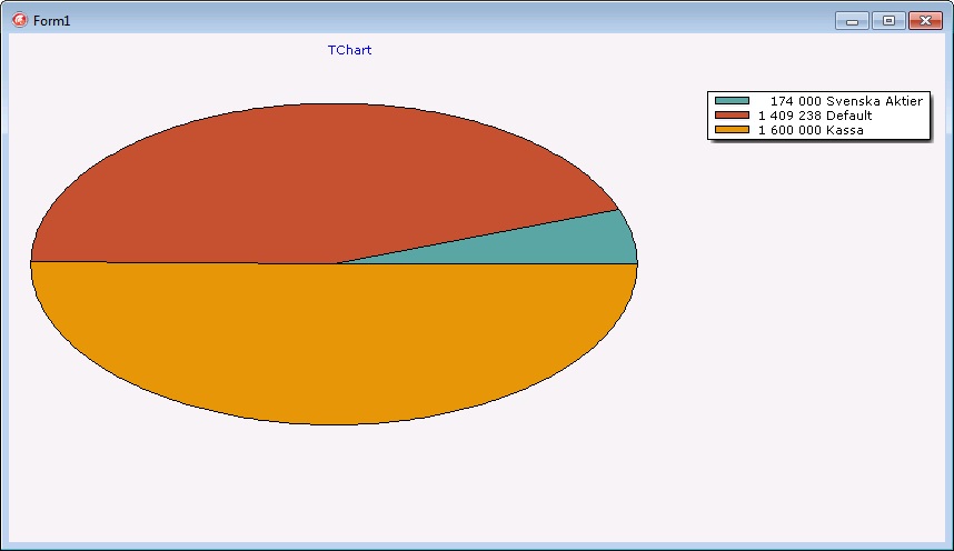

Changing the last slice value:
3d "effect is gone"
Pie not ok.jpg (48.14 KiB) Viewed 5237 times

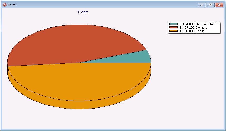

Changing rotation fixes 3d effect:
Changing rotation fixes it
Pie ok again.jpg (55.36 KiB) Viewed 5225 times
Changing the first pie value to 0 will also remove the 3d effect.
