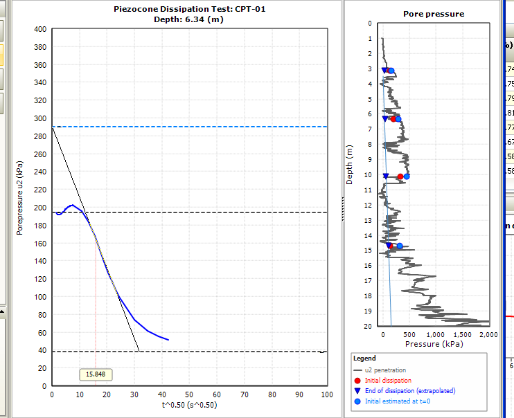

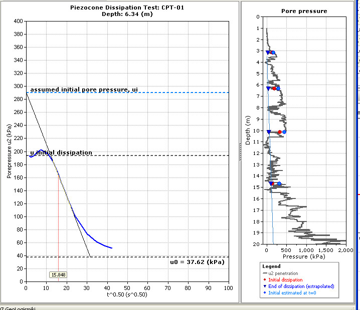

Here are 2 images to see how the new charts appear after importing the project file to XE6 (no code changes).
- Xe6.png (137.15 KiB) Viewed 36394 times
- D2007.png (86.2 KiB) Viewed 36388 times

I've made a simple project with just a v2012.07 chart on a form and a TBarSeries. I've modified the left axis pen width and I've set a title to the left axis. Then I've saved the project and opened it with XE6 and TeeChart v2014.11. I see the chart still uses GDI, conserves the axis pen width, margin in the left axis title and I see no white labels at the axes nor at the bar marks.
Do you mean the axis labels drawn on the ticks or the series marks?johnnix wrote:It looks like that the tick marks color is now set at white
Can't reproduce this here.johnnix wrote:I lost the pen width of the axis
Can't reproduce this here.johnnix wrote:there is something wrong with the margin values (left axis caption is half visible cause it now moved close and over the edge of the component)
Can't reproduce this here.johnnix wrote:but most important when I open the D2007 project file with XE6 everything appear to be drawn with GDI+. My first concern is how I can prevent that (I already check the registry settings and the default canvas entry is blank). Indeed if I drop a new TChart object on a form it is obvious that GDI is used.
