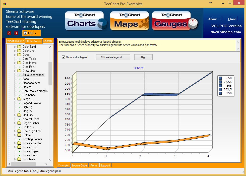

I've been unable to use the TExtraLegendTool recently, regardless of the legend options, the extra legend does not show anywhere on the chart.
After a while, i've realised that the TeeChart Pro demo 2014 exhibits the same behavior.
I might be mistaken, but it looks like a regression no ?

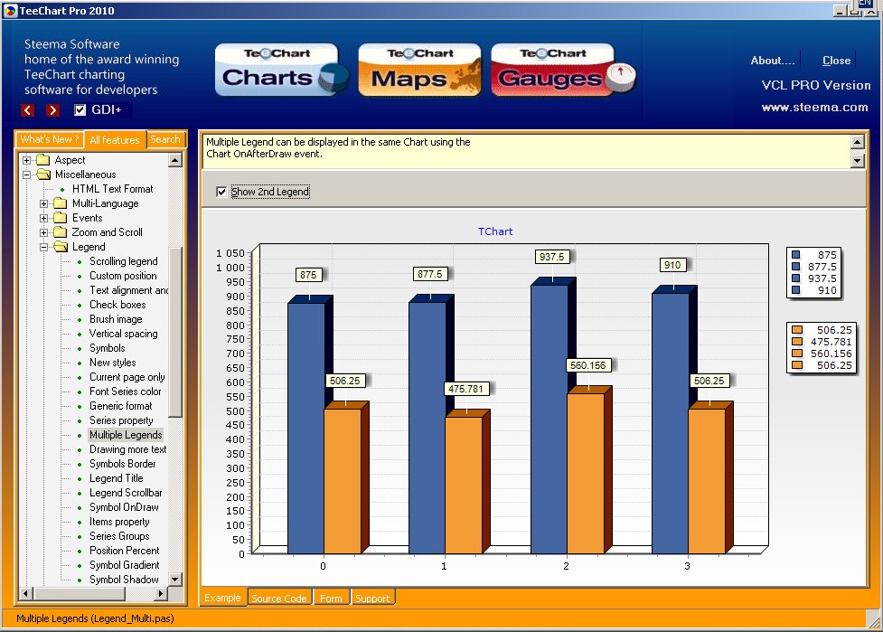

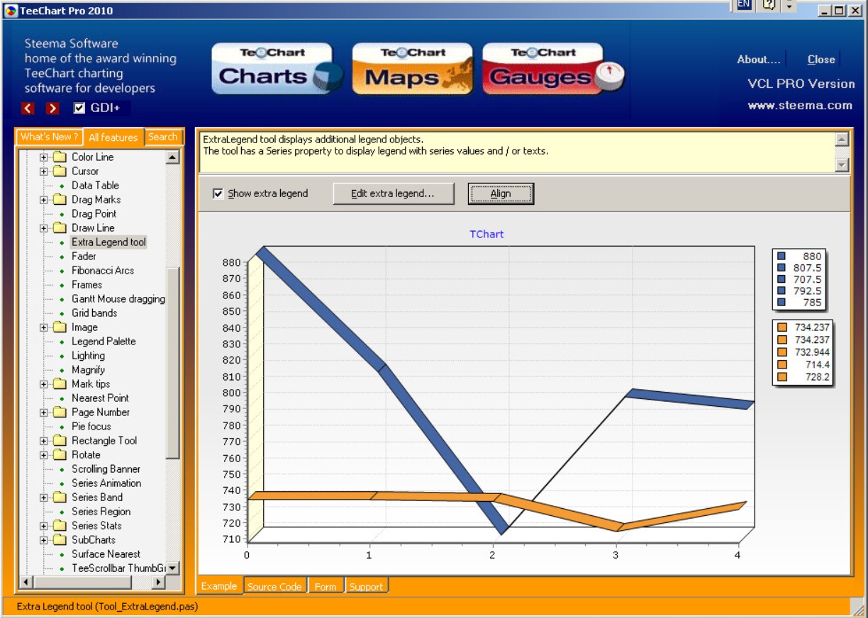

See attached screenshots.

current behavior
Expected behavior

current behavior
expected behavior

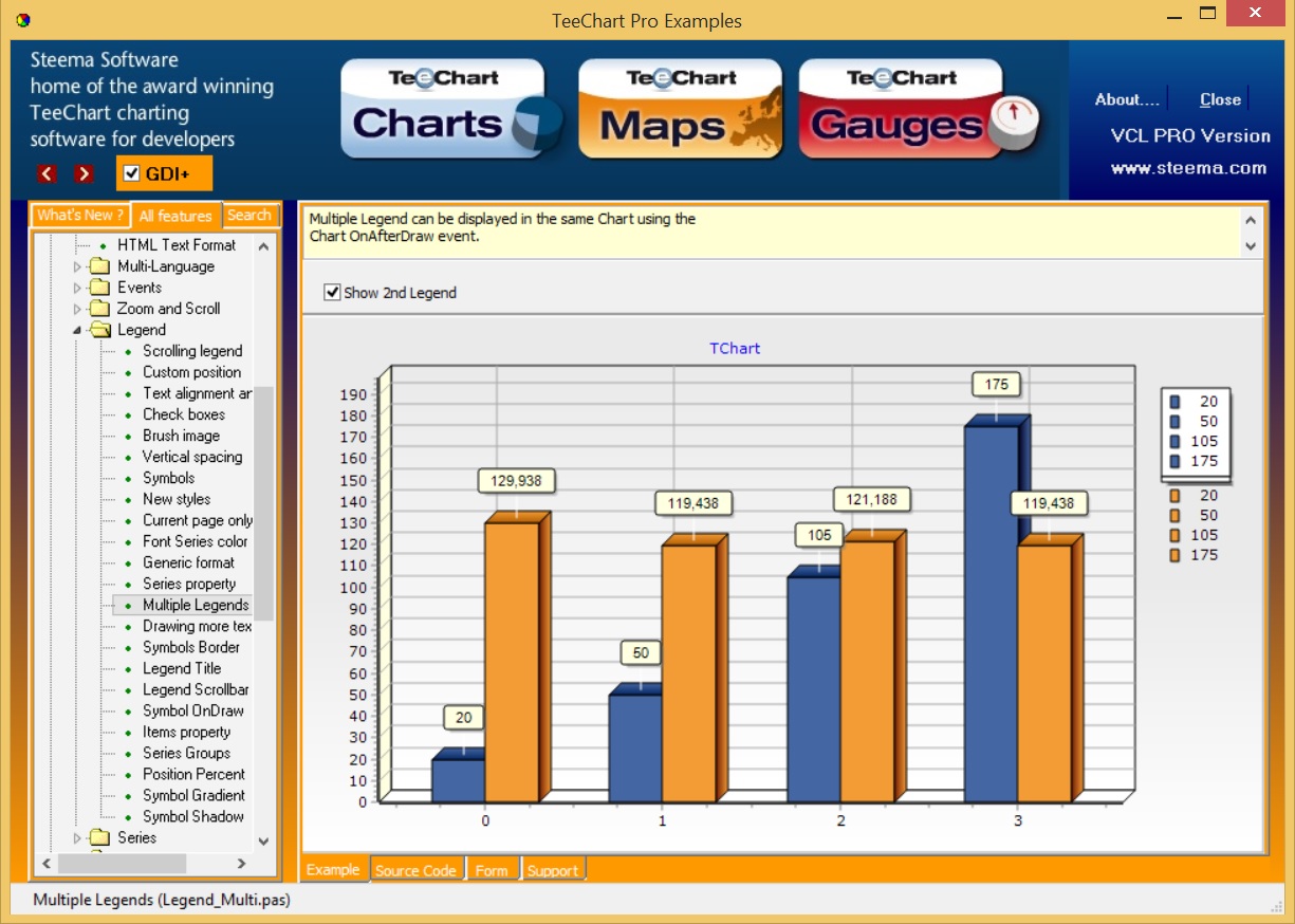

On a side (and probably unrelated note), there seems to be a slight glitch in the legend-canvas drawing stuff
in the latest demo of Multiple Legend in the demo of Tee9New_win32.exe
(GDI+ selection/deselection does not impact the resulting output)
Bottom line is, getting multiple legend is a tricky business in version 2014.10.140220 (VCL)
Thanks in advance for your help,

dsn wrote:I've been unable to use the TExtraLegendTool recently, regardless of the legend options, the extra legend does not show anywhere on the chart.
I've reproduced the problem so I've added it to the public tracker:
http://bugs.teechart.net/show_bug.cgi?id=755
Feel free to add your mail to the ticket CC list to be automatically notified when an update on it arrives.
dsn wrote:On a side (and probably unrelated note), there seems to be a slight glitch in the legend-canvas drawing stuff
I've also reproduced this and added it to the public tracker:
http://bugs.teechart.net/show_bug.cgi?id=756
