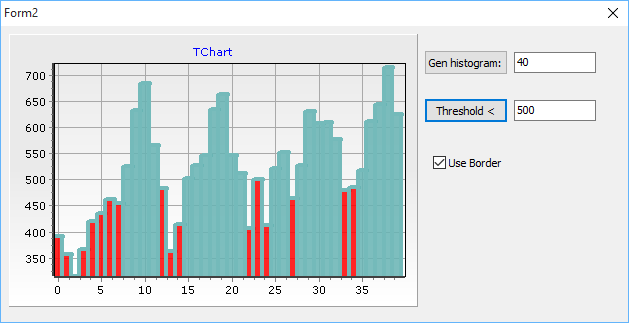

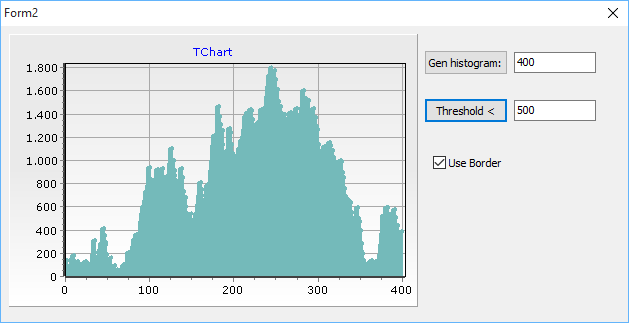

Back then the THistogramSeries looked like this:

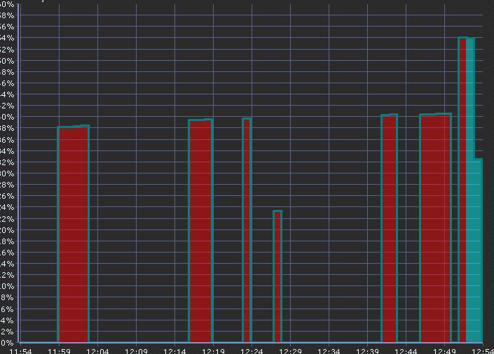

With - at least - the last two versions (I can't go back this far with my project) it looks like this:
As you can see the historam seems to be a TBarSeries with connected bars rather then a histogram. This is especially bad as - when more data gets added - only the border can be seen now (losing all the red areas!!).
I couln'd find an option to turn the old behaviour back on so I hope you do have that hidden somewhere - or can at least give me a patch do bring this back on!
In addition with the latest (Delphi Seattle) Version there is also an ugly offset, shifting the top border a few pixels to the right:

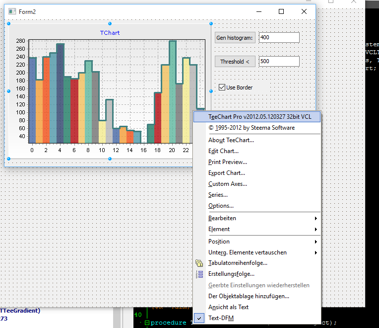

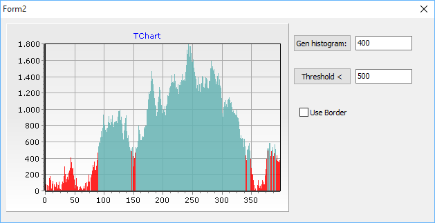

I added a demo project (and an exe-File which needs all the run time packages).
If you just run it as it is it generates 400 Samples and marks any value below 500 in red this looks like this:
I can't reproduce old behavior but the screen-shot from the last post was taken from an older version of my software.
I found out that removing the border does show the correct values (uncheck "Use Border") but then the bold outline is also gone and it looks like this:

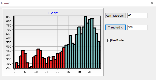

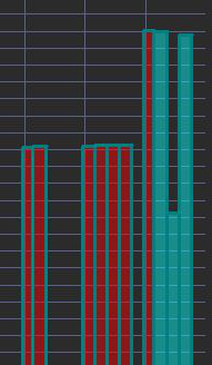

No if you use 30 samples and turn the border back on you get:
Which shows the "bar-like" border and the shifted offset at the top...
Note: When experimenting you might need to press "Gen histogram:" a few times to get one with values below and above the current threshold! In addition you need to click "Threshold <" after generating a new histogram (or else all values stay in the original color).

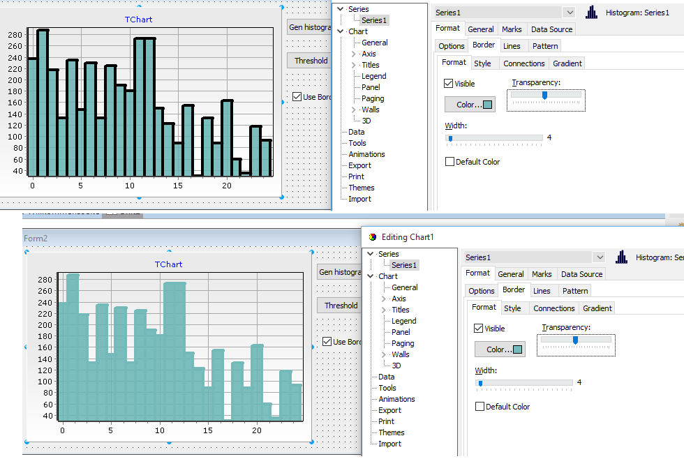

While at it, I also found out that the Transparency of the border it self doesn't work and has a real strange behaviour:
Open the bars options:
like in the image above, klick the "Transpareny:" Trackbar und use the left-/right cursor keys of your keyboard to increment or decrement that Transparency value just by 1 each time.
This was the border "flips" between the selected color and black back and force with each value change.
If you compile and run the application there is no transparency of the border either way but in "black"-State it looks like this (showing the shift bug even sharper):
Note: I do not yous border transparency as I liked the old behaviour of the histogram, having a bold - nontransparent - outline and a proper colord semi-transparent interior.

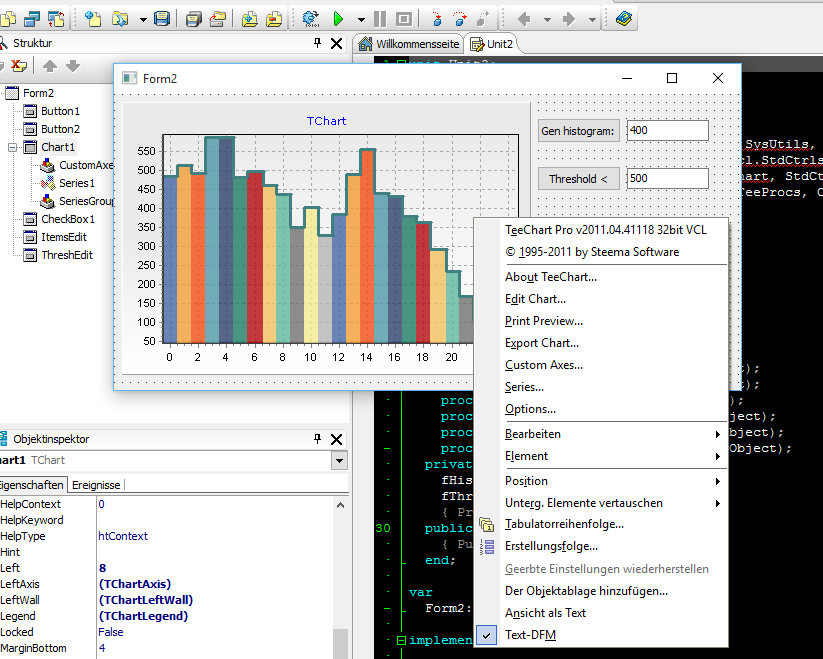

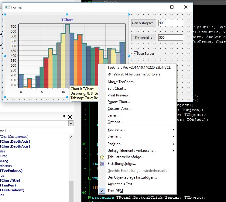

I was lucky to find an older installation on my PC to show you how THistogramSeries worked before it got broken:
In fact I was able to install a newer version of TChart and there its working too:
...and as I was at it, I installed 2014.10 which also seems to be ok:

Post by Yeray » Thu Sep 17, 2015 1:33 pm
I see the problem appeared in v2014.12.
I've created a ticket for it and found a fix, so the next maintenance release will include it.
http://bugs.teechart.net/show_bug.cgi?id=1310

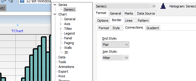

We've seen setting a different Pen.EndStyle doesn't give that "offset". Could you please check if it gives the result you desire?
Histogram1.Pen.EndStyle:=esFlat;

I also tried your suggestion but setting the connection end style to flat produces "steps" instead of an offset.
in conjunction with a border width of 3 they have just the size of a pixel (so that would be acceptable) but with thicker borders its highly visible (see attachment).
