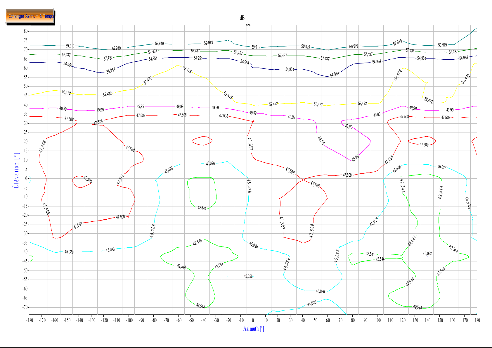

Is it possible to extract le numerical values of a contourseries for each of the selected levels?

What I would like to retrive are to points for each of the above colored lines at the different selected levels.
In the above example, I have lines at Level=59.919 . Level=57.437, ... some levels can be splitted in diffent level curve (here for example L=42.544 or 47.508 or...)
The goal is to save the equipotential/isothrm/equi-xxx positions for an external use.
best regards

I understand you are looking for the arrays of Points into the Segments into the Levels. Here you have a simple example printing all the X and Y values for each Points array in each Segment in each Level:
