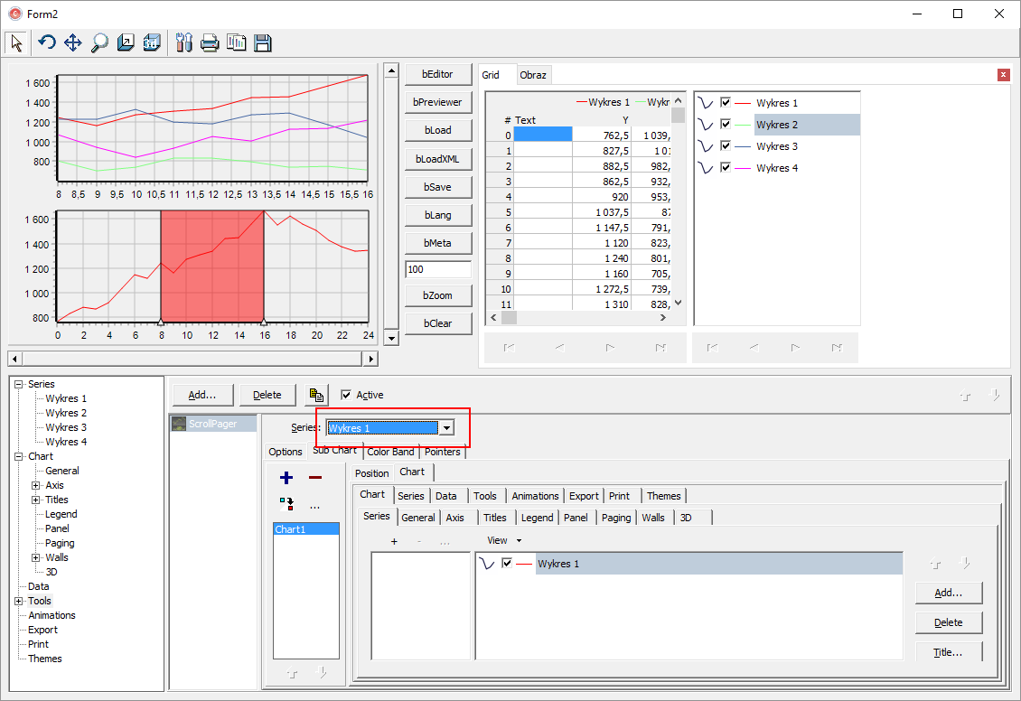

1) Add 3 line series to the chart.
2) Add ScrollPager on that chart
3) Try to switch ScrollPager series from 1st to 3th serie

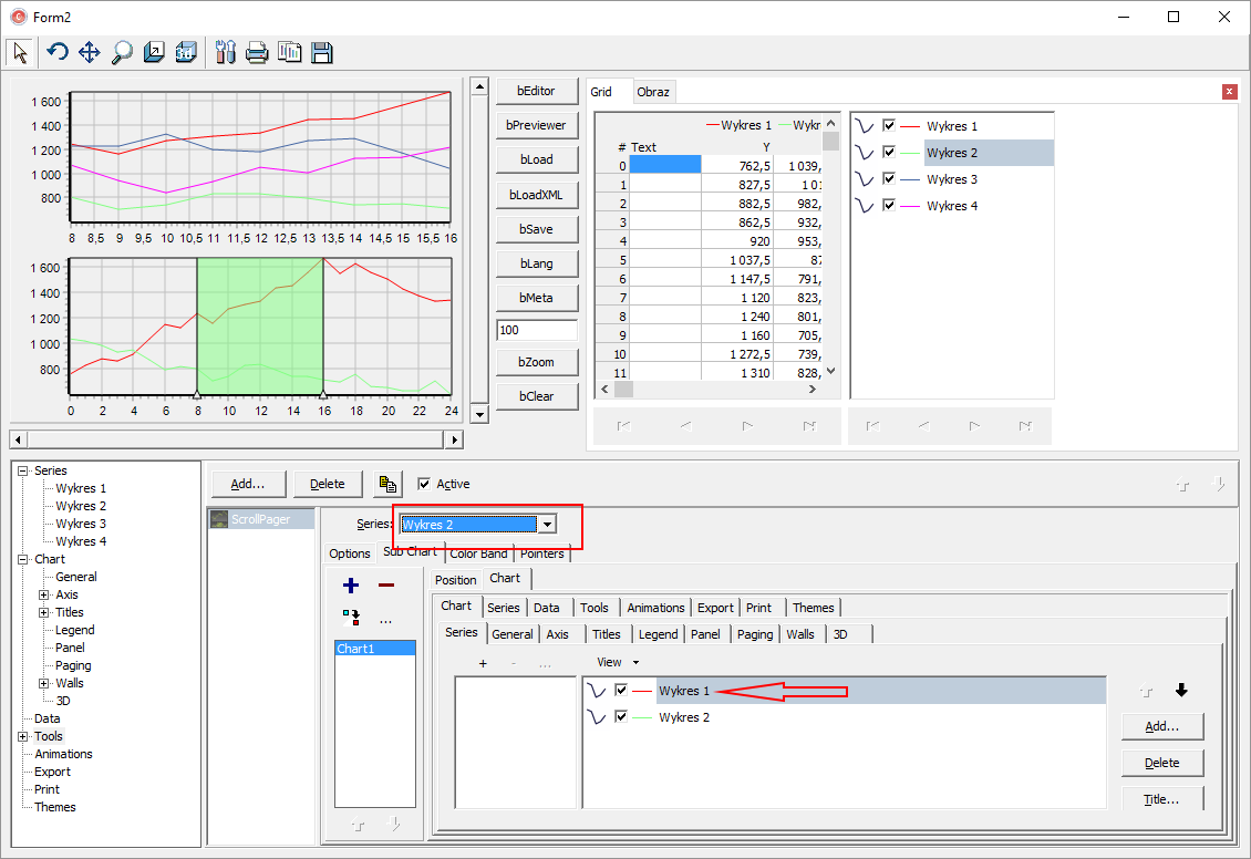

In the underlying sub-chart the previous selected serie are not removed. So when one switch from serie1 to serie2 the are always 2 series in sub-chart.

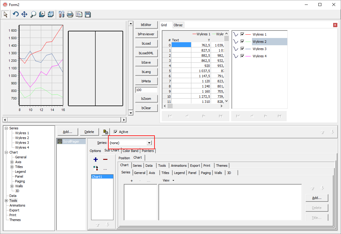

Series (none) is selected
Switch to "Wykres 1"
Switch to "Wykres 2"
"Wykres 1" are not deleted from sub-chart.
