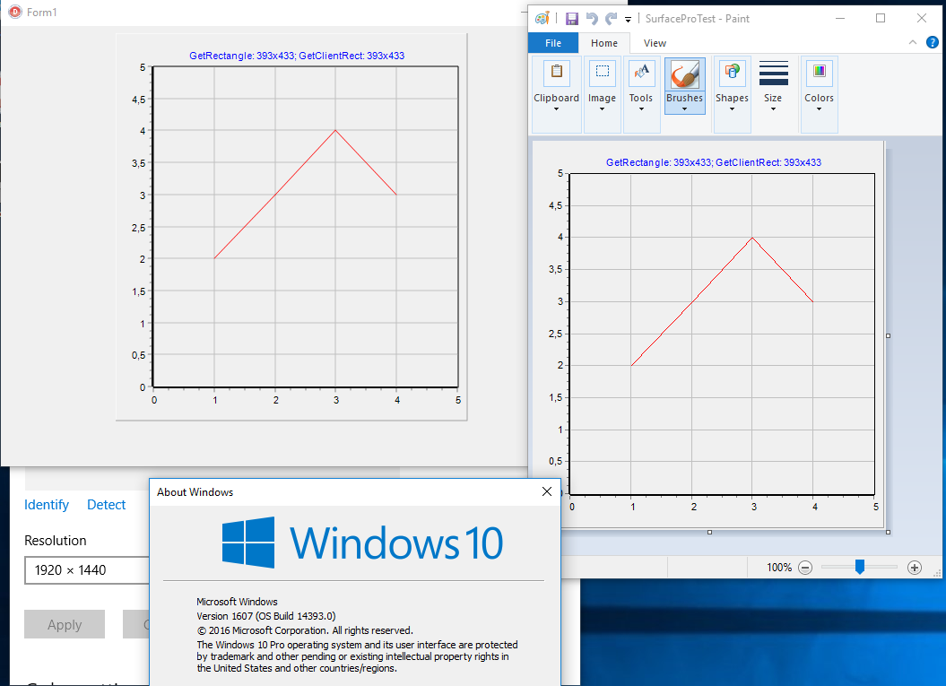

I found some problems to emulate the resolution of the Surface Pro 3 here (2160x1440). Finally I achieved it doing this, but I'm afraid I can't reproduce the problem with a virtual machine running the same OS and resolution:

I compiled SurfaceProTestDelphi project on Delphi XE8 (TeeChart Pro v2016.19.161025 32bit).
Tested on device Pipo X10 (Windows 10 version 1511 build 10586.589).
There I have even bigger difference so I think it is because on surface desktop was scaled by 150% and on Pipo I have scaled by 200%.
