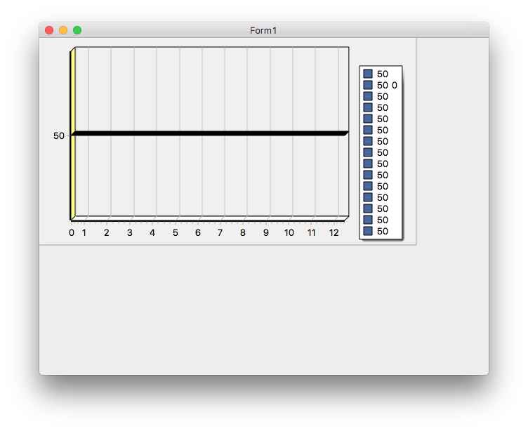

I've just tried the code in the ticket #1701 in TeeChart v2017.21 using RAD 10.2 and it seems to work fine for me on OSX:
Screen Shot 2017-04-10 at 12.35.13.png (44.35 KiB) Viewed 31584 times

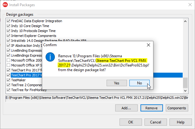

There are several ways to do this, but note that, after several TeeChart installs, you can have a TeeChart version installed as design time package but the paths could be referencing a path to another version, so the later is used to compile and run the project:
- Design-time packages: Go to "Component \ Install Packages..." and check the TeeChart packages in the list. A trick to see the full path of a package is to select it, click "Remove", read the path, and cancel the remove operation.

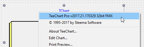

- Design-time packages: Open a form containing a form (or create it), right click with the mouse on the chart and read the "About" version.

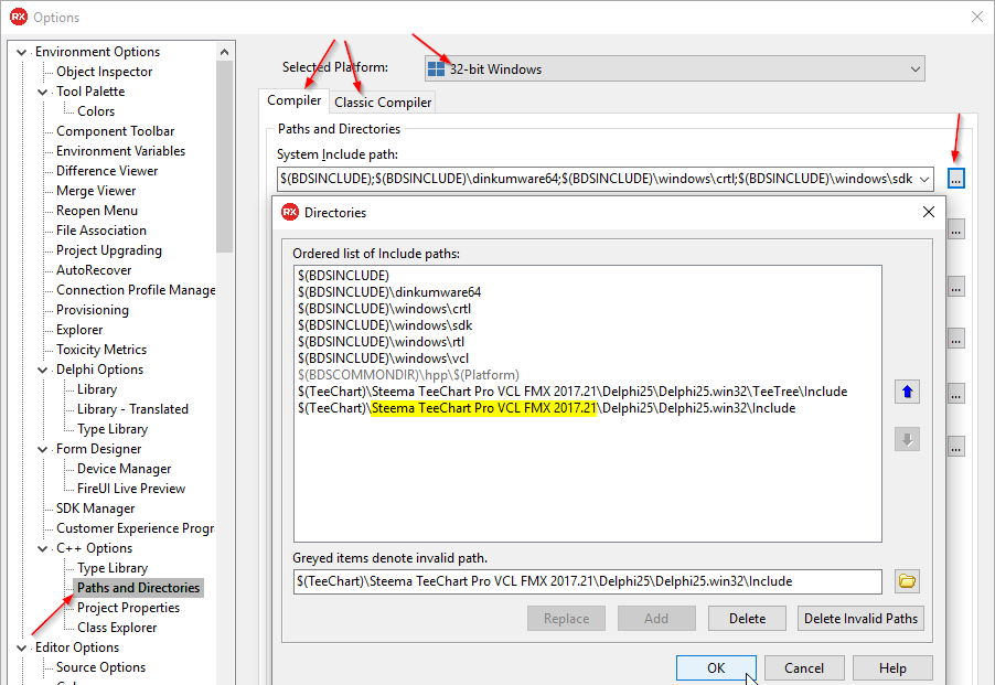

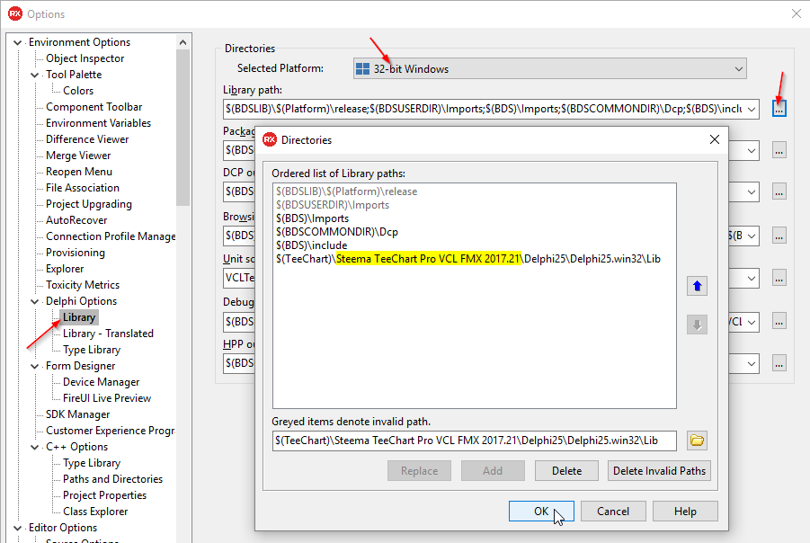

- Runtime packages (Delphi): Check the library path:

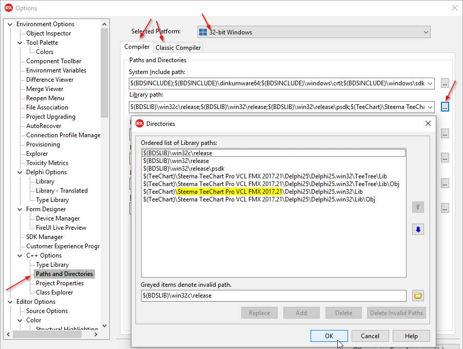

- Runtime packages (C++Builder): Check the include and the library paths:
