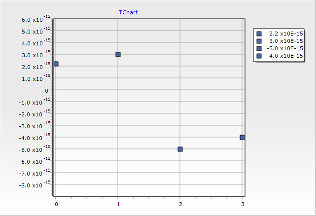

Hello Jim,
I'm trying to reproduce the problem but I always get all the axis labels drawn.
First, having values in the order of e-15, I get all the labels in the left axis rounded to 0:
uses Series, Math;
const exp = -15;
var base: Double;
  base:=Power(10, 15);
  Chart1.View3D:=False;
  with Chart1.AddSeries(TPointSeries) as TPointSeries do
    Add(2.2/base);
    Add(3/base);
    Add(-5/base);
    Add(-4/base);
  Chart1.Axes.Left.SetMinMax(-9/base, 6/base);
  Chart1.Axes.Left.LabelsExponent:=True;
Using ValueFormat and AxisValuesFormat I an see the real values both in the legend and in the left axis labels.
In this case, I still see a label where the '0' should be, but it's represented as a really small value () instead of just '0':

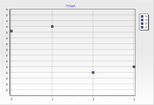

uses Series, Math;
const exp = -15;
var base: Double;
    myValueFormat: string;
  myValueFormat:='#.# x10E-#';
    Add(2.2/base);
    Add(3/base);
    Add(-5/base);
    Add(-4/base);
    ValueFormat:=myValueFormat;
  Chart1.Axes.Left.AxisValuesFormat:=myValueFormat;

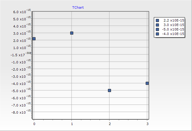

To solve it I can use OnGetAxisLabel event as follows:
procedure TForm1.Chart1GetAxisLabel(Sender: TChartAxis; Series: TChartSeries;
  ValueIndex: Integer; var LabelText: string);
var index, tmpExp: Integer;
  if (Sender=Chart1.Axes.Left) then
    index:=Pos('E', LabelText);
    tmpExp:=StrToInt(Copy(LabelText, index+1, Length(LabelText)));
    if tmpExp<exp then
       LabelText:='0';

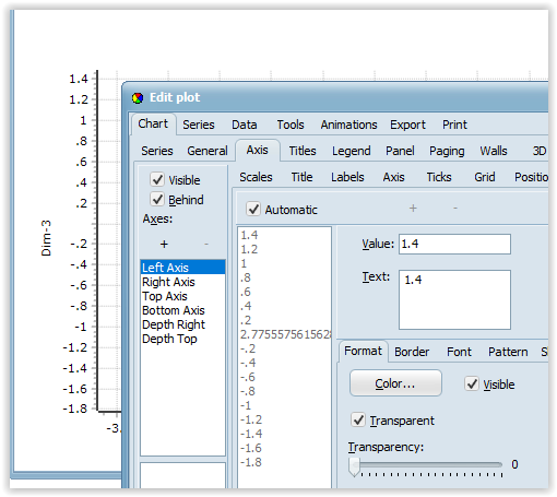

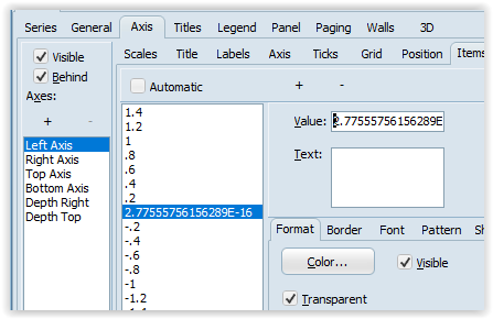

I have also found it difficult to construct a little test program to demonstrate the problem. I have attached screenshots to illustrate the problem and to show the values I find when I use the editor.
The lower plot shows a little of the left axis with the blank where a zero should be. I have overlapped it with the editor displaying chart.axis.items. You can see a strange value where one would expect a 0. The other screenshot shows what one gets after unchecking 'automatic' so I can widen the control so you can see the value (-2.77555756289E-16) that is there.
It looks like some rounding error in stepping from -1.4 to 1.4. Zero comes out a little off.
I hopes this helps clarify the problem.
Jim

If it helps, the min and max values for that axis were: -1.51940616855679 and 1.59310121515679. The increment shows as blank because it was automatically generated. Within the editor I tried various values for the increment but the zero item still displayed as blank. Within the editor I then played around changing the min and max values. The scale changed of course but the zero label stayed blank.
