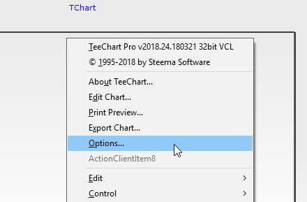

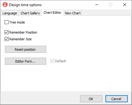

Do you mean some confirmation dialog in the TeeChart editor?
The only form size and position saved can be reset at the "Options" dialog, accessible at design time:

Thank you. That seems to fix it while I'm in the IDE but if I restart it, I have to reset the positions again.

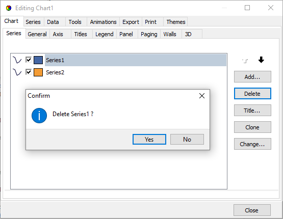

The confirmation dialog shown when you are about to delete a series:
This window is positioned relative to the series listbox. Here the code at TeePenDlg.pas:
Function TeeYesNo(Const Message:String; Owner:TControl=nil):Boolean;
var x : Integer;
    y : Integer;
Begin
  Screen.Cursor:=crDefault;
  if Assigned(Owner) then
    x:=Owner.ClientOrigin.X+20;
    y:=Owner.ClientOrigin.Y+30;
    result:=MessageDlgPos(Message,mtConfirmation,[mbYes,mbNo],0,x,y)=mrYes;
  end
  else result:=MessageDlg(Message,mtConfirmation,[mbYes,mbNo],0)=mrYes;
End;
