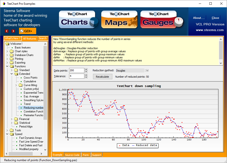

webadm wrote:Reducing the points to be painted for sure will help. Do you have an example of TDownSamplingFunction I can look?
Yes, you can look at the "Reducing number of points" example at the "Features Demo". Sources here:

I will take a look a the example and see if that could be a solution for my problem.
