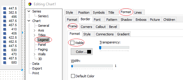

Example 1: See LegendBorder.png attachment.
On the GUI, I change Chart -> Legend -> Format -> Border -> Frame -> Visible to remove the border around the legend.
What property do I change at runtime to achieve this?

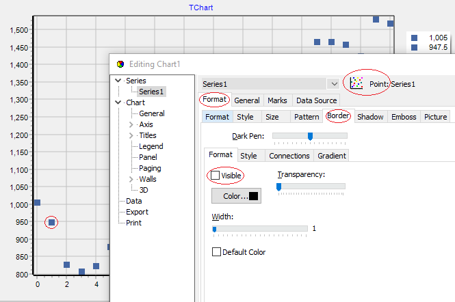

Example 2: See PointSeriesBorder.png attachment.
On the GUI, I change Series -> Format -> Border -> Visible to remove the border around the points.
Chart1.Legend.Pen.Visible := false;
Series1.Pointer.Pen.Visible := false;

Thanks Sandra!
Your solution to remove the border around the points works well.
To remove the border around the legend, I eventually discovered this code:
Chart1.Legend.Frame.Visible := false;
Although different from your code, it seems to work as desired.
