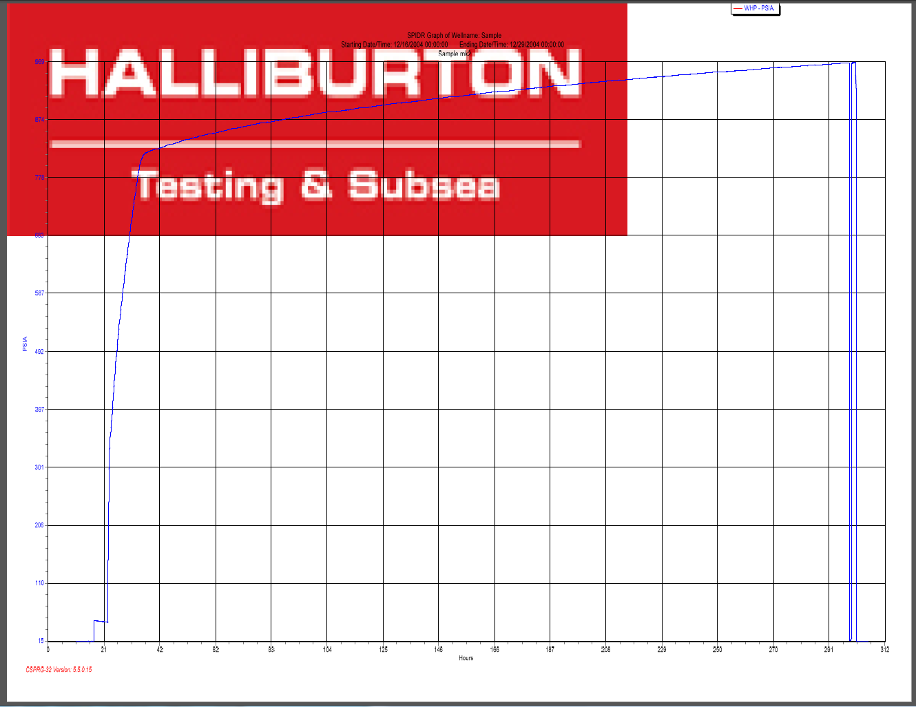

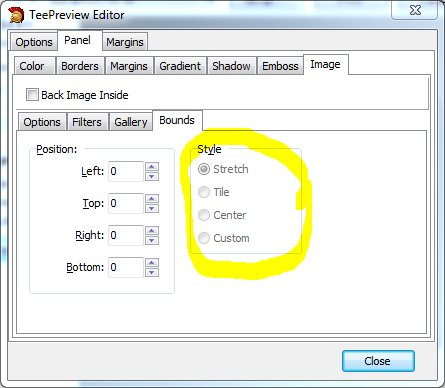

I noticed that the custom graphic that I placed on the panel is stretched when the graphic is set to the printer. I noticed that the Bounds Tab of the Image Tab of the Panel Tab is always set the Style to Stretch and the Style can not the changed because it is grayed out. (See the attached screen shot 'TEEChart.png').

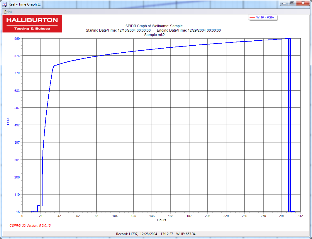

I have included a ScreenShot of the graph as it appears on the screen (Sample.png)
And a Screen shot of the output set to a PDF printer driver, the same occurs when set directly to a printer (SampleOutput.png)

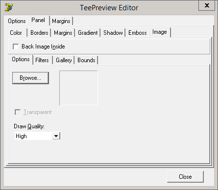

BVSimmons wrote:I noticed that the Bounds Tab of the Image Tab of the Panel Tab is always set the Style to Stretch and the Style can not the changed because it is grayed out. (See the attached screen shot 'TEEChart.png').
These options are greyed out if you don't have an image loaded in the same editor, here:
