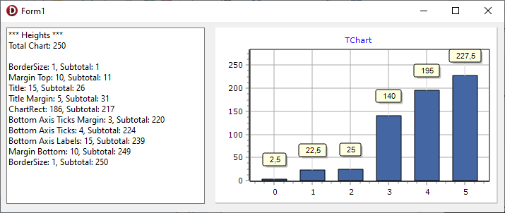

I did an example trying to show all the heights involved in a simple chart:

  Memo1.Lines.Add('*** Heights ***');
  Memo1.Lines.Add('Total Chart: ' + IntToStr(Chart1.Height));
  Memo1.Lines.Add('');
  total:=0;
  AddValue('BorderSize', TCustomTeePanelAccess(Chart1).BorderSize);
  if (Chart1.MarginUnits = muPixels) then
     AddValue('Margin Top', Chart1.MarginTop)
     AddValue('Margin Top', Chart1.Height*Chart1.MarginTop div 100);
  AddValue('Title', Chart1.Title.Height);
  AddValue('Title Margin', Chart1.Title.VertMargin);
  AddValue('ChartRect', Chart1.ChartRect.Height);
  with Chart1.Axes.Bottom do
    AddValue('Bottom Axis Ticks Margin', Axis.Width+1);
    AddValue('Bottom Axis Ticks', TickLength);
    AddValue('Bottom Axis Labels', Abs(LabelsFormat.Height));
    AddValue('Margin Bottom', Chart1.MarginBottom)
    AddValue('Margin Bottom', Chart1.Height*Chart1.MarginBottom div 100);
