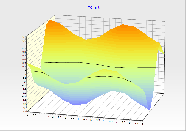

How to make an isosurface plot where all contour lines are disabled except one?
For example Series1.BandPen.Visible:=False for all levels except for the level Y=10

Post by Yeray » Thu Jun 16, 2022 9:38 am
I'm afraid there's no property to do this.
However, you can do a trick. You can draw the series twice.
- First, draw the series without BandPen the first time, and prepare a special palette with a single Level .
- Secondly, draw the series without Brush and with a custom Palette which has a single Level with the desired UpToValue.
Ie:
type TIsoSurfaceAccess=class(TIsoSurfaceSeries);
  Chart1.Legend.Hide;
  Chart1.Aspect.Orthogonal:=False;
  Chart1.Aspect.Zoom:=70;
  Chart1.Chart3DPercent:=100;
  with TIsoSurfaceSeries(Chart1.AddSeries(TIsoSurfaceSeries)) do
    FillSampleValues;
    BeforeDrawValues:=Series1BeforeDrawValues;
procedure TForm1.Series1BeforeDrawValues(Sender: TObject);
var t: Integer;
  with TIsoSurfaceAccess(Chart1[0]) do
    // Restore the series to draw the cells with the Brush but without the BandPen
    Brush.Style:=bsSolid;
    CreateDefaultPalette;
    BandPen.Visible:=False;
    DrawAllValues;
    // Prepare the series to draw the BandPen with the modified palette, without the Brush
    BandPen.Visible:=True;
    Brush.Style:=bsClear;
    CreateDefaultPalette(1);
    Palette[0].UpToValue:=0.2;
