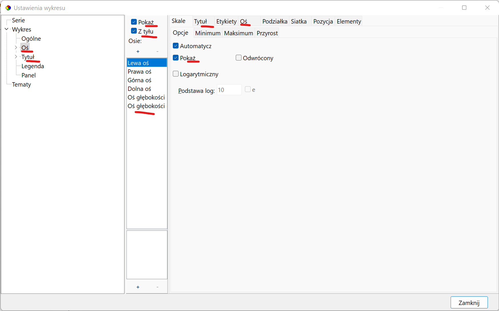

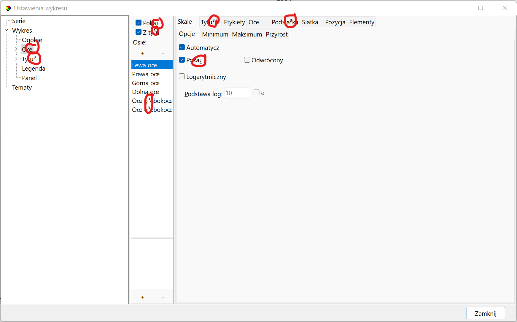

3. After installation but before compilation VCL there are 2 language files - in my example for Polish: TeePolish.pas and VCLTee.TeePolish.pas (maybe also FMX one). First is ANSI encoding, second one UTF-16LE. The UTF-16LE version is broken about translations. It produce this:
bad encoding.png (66.62 KiB) Viewed 14352 times
After every update i have to copy content from TeePolish (ANSI) to VCLTee.TeePolish (UTF-16LE) and change conding of file to ANSI or convert external for UTF-16LE. After this i get proper text:
Can it be repair? I've searched forum but i don't find that anyone else had this problem.

After installation Steema VCL i found 7! language files for Polish language but they are the same. These files are:
  • FMXTee.Language.Polish.pas - (..\Source\FMX\)
  • FMXTee.Language.Polish.pas - (..\Source\UnicodeLangs\FMX\)
  • FMXTee_Language_Polish.pas - (..\Source\UnicodeLangs\FMI\) - what is FMI? is there a mistake
  • VCLTee.TeePolish.pas - (..\Source\VCL\)
  • VCLTee.TeePolish.pas - (..\Source\UnicodeLangs\VCL\)
  • TeePolish.pas - (..\Source\)
  • TeePolish.pas - (..\Source\UnicodeLangs\VCL\)
Some of the files are encoded in ANSI and some in UTF-16 LE BOM. File VCLTee.TeePolish.pas located in "..\Source\VCL\" have good translation (encoded in UTF-16 LE BOM). I've opened that file in Notepad++ and copy/paste it's content to the VCLTee.TeePolish.pas located in "..\Source\UnicodeLangs\VCL\" (also encoded in UTF-16 LE BOM but with errors in encoding). After recompile TeeChart i got proper translation in VCL in Delphi. I think the same should be done for FMX.
The question is why there are so many same language files? Cannot just one be used globally for all platforms?
The files differ only in name and theoretically in the directives used, but these directives do not change anything in the file - I checked the references to other units.
Isn't it better to simplify these translations and leave only one language file for each language?
