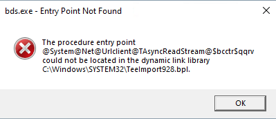

When I open Delphi 11, I get this error
The procedure entry point @System@Net@Urlclient@TAsyncReadStream@$bcctr$qqrv could not be located in the dynamic link library C:\Windows\SYSTEM32\TeeImport928.bpl
I have installed/uninstalled (Run as administrator) several times TeeChartVCLFMX-2022.36.exe Build 2022.36.220929, but it always shows the same error.
Specifications of my Windows and Delphi:
Windows 11 Pro Version 21H2 OS build 22000.1455
Embarcadero® Delphi 11.0 Version 28.0.42600.6491
I don't have Delphi's Teechart Standard installed and I don't have any other versions of Delphi installed.
Can someone help me how to solve this error?
The procedure entry point could not be located in the dynamic link library TeeImport928.bp
- LoadingTeeChartError.png (17.04 KiB) Viewed 12936 times

However, when opening RAD Studio 11 it still shows the same error:
