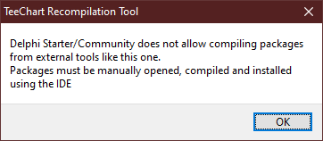

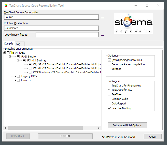

I ran TeeRecompile "as Administrator", here are the options and result...
2023-01-17 18_34_42-.png (35.43 KiB) Viewed 20420 times
2023-01-17 18_38_04-TeeChart Recompilation Tool.png (4.53 KiB) Viewed 20420 times
Re: Install TeeChart VCL with Source into Delphi 10.4 Community
Post by Yeray » Wed Jan 18, 2023 7:36 pm
Sorry, I didn't remember Community versions of RAD Studio don't support command line compiling.

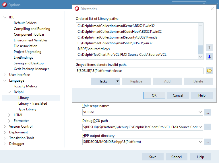

Make sure you have the "C:\Delphi\TeeChart Pro VCL FMX Source Code\Source\VCL" path int he library path and also put the "VCLTee" prefix in the "unit scope names".
dwpss
Posts: 11
Joined: Wed Dec 14, 2022 12:00 am
Post by dwpss » Thu Jan 19, 2023 12:17 am
No difference.
Screenshot 2023-01-18 191608.png (40.86 KiB) Viewed 20388 times

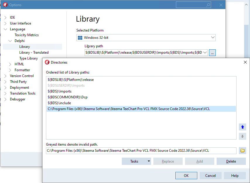

Does the path ("C:\Delphi\TeeChart Pro VCL FMX Source Code\Source\VCL") contain the TeeChart prefixed units?
Are you trying with a new simple project?
The steps I just did:
- Install TeeChart v2022.36 binary version. You need this if you want to access the components at design-time. It will also allow you to install the help files and examples locally (the source code installer doesn't include them).
- Open the IDE. Add the VCLTee prefix to the "unit scope names". Create a new project. Drop a TChart component into the form. Make sure it builds and runs fine. Close the IDE.

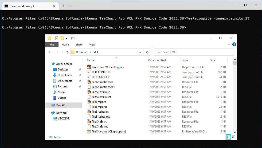

- Install TeeChart v2022.36 source code version. Run TeeRecompile from command line with the -generateunits 27 argument to generate the prefixed units without even trying to build them.

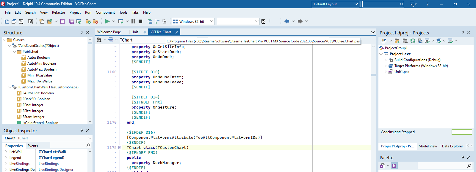

- Open the IDE again. Correct the paths. Create a new project. Drop a TChart component into the form. Make sure it builds and runs fine. Try Ctrl+Click to the TChart class to see if the sources are found and navigation works fine.
