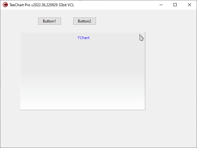

I've just given it a try with the same version, just in a new application with a TChart two buttons and the code below, and it seems to work pefectly:
Unit1.h:
#include <VCLTee.TeePNG.hpp>
#include <VCLTee.TeeConst.hpp>
Unit1.cpp:
#pragma link "VCLTee.TeePNG"
void __fastcall TForm1::FormCreate(TObject *Sender)
  this->Caption=TeeMsg_Version;
  Chart1->Walls->Hide();
  Chart1->Axes->Hide();
void __fastcall TForm1::Button1Click(TObject *Sender)
  Chart1->BackImage->LoadFromFile("E:\\tmp\\steema.png");
void __fastcall TForm1::Button2Click(TObject *Sender)
  Chart1->BackImage=NULL;
If you still find problems with it, could you please try in a new simple example?
